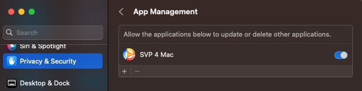

- Mount SVP 4 Mac DMG image
- Move “SVP 4 Mac” icon into Applications
- Run SVP, it will ask to run an installation script if needed.
- Alternatively, you can run the script later: SVP menu → Utilities → Reinstall mpv in Homebrew
