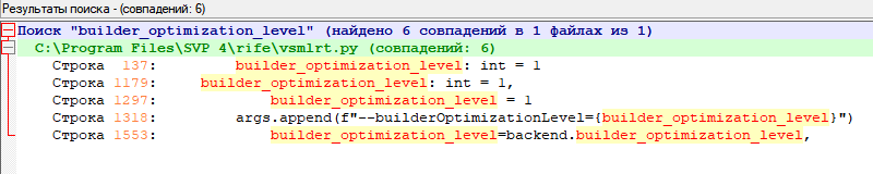

Could someone let me know how I’d be able to change my builder optimization level?
1,441 (edited by RickyAstle98 10-04-2024 16:12:09)
Line 137
Line 1179
Line 1297
изображение_2024-04-10_211202959.png, 16.96 kb, 800 x 160

1,442
RickyAstle98 wrote:
Line 137
Line 1179
Line 1297
Please do elaborate.. what is the impact of this? What are my options and how does it help? smile
1,443 (edited by RickyAstle98 11-04-2024 06:55:24)
scb wrote:
RickyAstle98 wrote:
Line 137
Line 1179
Line 1297
Higher optimization level the longer engine build times but more accurate dynamic tactics!
Level 0 : fastest engine build/performance drop (about -2%)
Level 1 : faster engine build/performance drop (about -1%)
Level 2 : fast engine build
Level 3 : default TRT execution level
Level 4 : DONT but DONT do that plz!
Level 5 : DONT but DONT do that plz!!! (+3% performance)
1,444 (edited by vulcan78 10-04-2024 23:30:48)

scb wrote:
RickyAstle98 wrote:
Line 137
Line 1179
Line 1297
There's very little benefit in changing it. I've played with many of the options including this one and the default settings are mostly the best settings.
