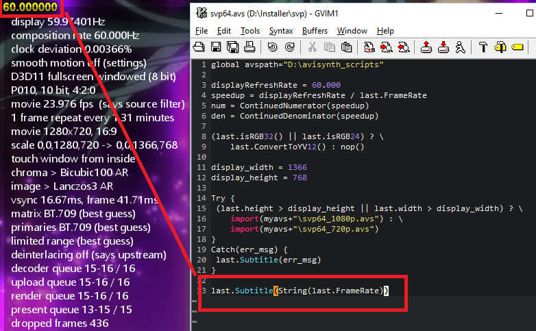

Check the attachment of my setting for exact 60fps smile
exact60fps.png, 248.35 kb, 782 x 483
5 (edited by ionutm80 17-05-2016 10:34:51)
Re: How to ensure perfect or close to 59.94 with NVidia
Hi, Am I missing something here ... or in fact for you is the same because display is at 59.974... and composition rate at perfect 60 which also translates in dropped frames.
My problems is not with the composition rate but with the display rate enforced by NVidia driver being 59.937 instead of 59.9400x as I'm getting with Intel HD4400 for instance ...
Or I'm loosing something?
Oh, sorry, I misunderstood your first post.
So, you want to make whether the SVP or display rate match exact each other, right?
If your concern about the different about ~0.01 which the cause of dropped frames, you can rest easy that it wasn't the case.
Dropped frames is purely because the system couldn't keep up with the calculation so in order to sync with the audio, the renderer starts dropping frames (CMIIW).
In my case, the current system I have has very low specs so it just couldn't play smoothly without closing other resource-intensive apps such as firefox and chrome.
As long the different doesn't differ too much, it's neglectable.
