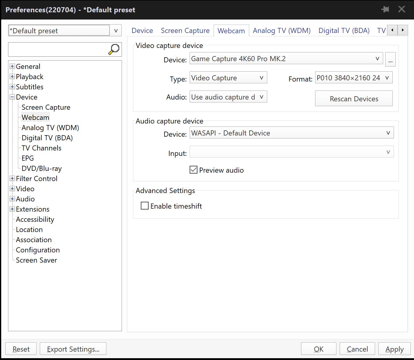

Tried other drives with write permissions but had no luck. Could be something that I am missing, not that tech savvy but here is what I am sure of:
Under Potplayer's selection preferences----> devices---->webcam(which is for capture cards as in my use case)---->format *PO10 selected*, Avisynth does not work anymore.
But under Potplayer's selection preferences----> devices---->webcam(which is for capture cards as in my use case)---->format *Any other selection besides PO10*, Avisynth works perfectly
there's no "P010" option there in my case
Hmm, I wonder if it varies with the card installed. Both my elgato and avermedia card have that selection. Below is mine pictured.
