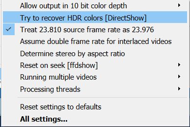

Since I'm passing the HDR data to  Madvr for tone mapping, am I right to disable all hdr options in SVP? Like So:
svp1.JPG, 32.75 kb, 390 x 260
Re: PUBLIC BETA TEST: AviSynth Filter - 10-bit/HDR in DirectShow
it doesn't apply in case of avsf + madvr
