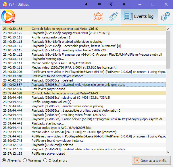

can I ask why the video and sound is delay when using Vapoursynth? got it to work on 64 bit potplayer 'cause of the update and I like it, the problem is delay on any anime that I tried.
Are you sure that potplayer  really uses vapoursynth? I have tried different combinations with zero effect, it still using avisynth. Check the SVP logfile.
Yes, already fixed the problem. Thanks
asgasgasgasgasgasgasgsagasgas.png, 56.05 kb, 602 x 582

20:11:40.506 [i]: PotPlayer: new video in PotPlayerMini64.exe (64-bit) [PotPlayer 0.0.0.0] on screen 0 using Avisynth engine
20:11:40.532 [i]: Media: video 1280x720 [PAR 1.000] at 29.747 fps [constant]
20:11:40.532 [i]: Media: codec type is AVC, YUV/4:2:0/8 bits
20:11:40.533 [i]: Playback: waiting for screens measurement...
20:11:41.024 [i]: Screens: screen 0 - 1920x1200 @59.953 Hz [measured], x1.3 [94 DPI]
20:11:41.024 [i]: Screens: primary screen is 0
20:11:41.024 [i]: Playback: starting up...
20:11:41.024 [i]: Playback [156749ee]: Frame server (64-bit) 0.1.0.0, AviSynth+ 0.1 (r2420, MT, x86_64), C:\WINDOWS\SYSTEM32\avisynth.dll
20:11:41.028 [i]: Playback [156749ee]: resulting video frame 1280x720
20:11:41.028 [i]: Playback [156749ee]: 2 acceptible profiles, best is '60fps' [0]
20:11:41.035 [i]: Playback [156749ee]: enabled while video is playing
20:11:41.049 [i]: Playback [156749ee]: playing at 59.494 [29.747 *2/1]
20:11:41.049 [i]: Playback [156749ee]: frame transformations are disabled in this video player
20:11:41.807 [i]: Performance: quick estimation = 550 (previous value was 552)
При этом типа все работает. Только плавности нет, OSD сообщений нет.
