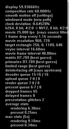

This isn't good either.
Clock deviation was -2% and was gradually going down (-0.65% on the screenshot)
"1 frame drop every 1.16 seconds" isn't good either; although those don't show up in "dropped frames"

Mystery wrote:
So we have to choose between memory leaks (and performance degradation) or constant freeze & crash.
I was feeling that something was slightly off performance-wise, but I guess I don't feel much the memory leaks with 8GB of RAM. How bad are those memory leaks?
And when it comes to the AviSynth+, does it do a better job besides the one bug you mentioned? I guess even a custom-build of AviSynth+ would be better than an unstable & old version of AviSynth 2.5.8 MT
You know what funny thing and sad joke is? That with those memory leaks anf 8GB onboard I can say "Well, FINALLY that RAM I payed for is used somewhere!" big_smile
Actually I have never known about them.
You should patch player's exe with 4GB patch.
I saw no bugs except 1 isolated in PotPlayer with disabled video processing option. My encoders use the AVS which came with them.
Clock deviation... have you ever thought it shoul be normal due to 59.937 fps ntsc (or whatever standard) being played on 60HZ monitor? Wait... maybe it's vice versa, your monitor's refresh rate is 59.9 instead of 60?
