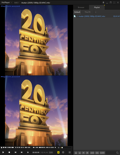

I've carefully followed the instructions, and I've also un-installed - rebooted - re-installed - rebooted, a number of times (using a new Windows 11 system).
So far, I am getting an indication that the MVC decoding is doing something (Intel MVC Decoder being used, 1920x2160 input source).
But all I can get is a tall stretched single eye image 1920x2160 aspect (See attachment).
I can't seem to get PotPlayer to render the left & right eye images.
I've tried playing with all the PotPlayer 3D options,but no luck.
Any suggestions what I can try next?
EDIT:  If I remove the Registered Filter (e.g. VapourSynth) to take SPV out of the picture, then PotPlayer 3D works fine.  I once again get Left & Right eye images (Top & Bottom).  So the problem with a stretched single eye image appears to be with SVP being introduced?
Also, I have no idea what "ensure main.setup.potplayer.native = false"  means?   What / where do I find "main.setup.potplayer.native". (assuming it has anything to do with the issue?).
PotPlayer_MVC_3D.png, 182.01 kb, 479 x 361

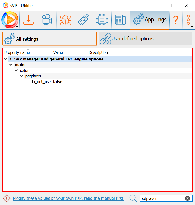

Application settings > Additional options > All settings...
type in Search window: potplayer
If you don't see native option then all is OK. it is mean native interface is not used in potPlayer.
potplayer_settings_svp.png, 52.36 kb, 827 x 871

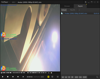

To clarify.  Currently, if I remove the Registered Filter (e.g. VapourSynth) to take SPV out of the picture, then PotPlayer MVC 3D works fine.  I once again get Left & Right eye images (Top & Bottom).  So the problem with a stretched single eye image appears to be with SVP being introduced?
Here's another image that shows SVP is activated.  But still getting a single tall stretched image.  Not the left & right eye images that appear correctly if I remove VapourSynth / SVP.
PotPlayer_MVC_3D_2.png, 106.23 kb, 399 x 316

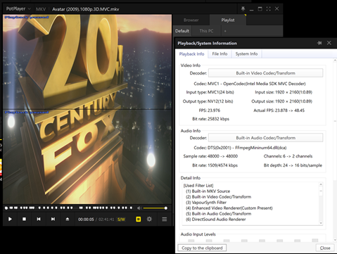

Here's how it looks with the Registered Filter removed (without SVP), showing correct Left eye & Right eye images.
PotPlayer_MVC_3D_3.png, 192.46 kb, 397 x 513
Re: Howto: play BD3D with SVP using MPC-BE or Daum PotPlayer
actually, no idea why it doesn't work in PotPlayer anymore
maybe they broke something... cause Avisynth/Vapoursynth Filter only shows 1920*1080 video size
use MPC-BE, it surely works as expected
