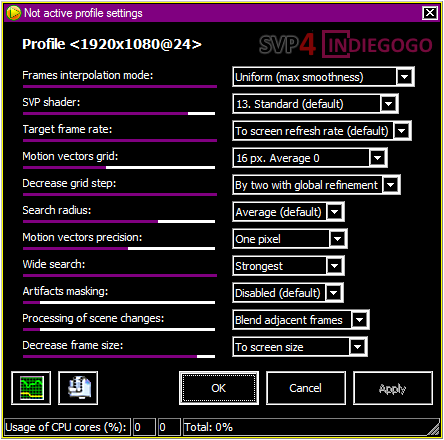

EDIT: Ok, so first off I need to establish a base-line.  For the following 1080p SVP settings, can you tell me how the CPU performance is for film-like content and how the artifacting is for anime content?
If performance is good, then try setting the 'SVP shader' to "Complicated" - this should be too much for film-like content but it might still be fast enough for anime content.

FYI, if you take the SVP settings I posted just above and change the shader to "Complicated", it seems like that may be a good setting for 10bit 720p anime...at least performance-wise.
EDIT: For 8bit 720p anime, take those same settings I posted above but with the following changes:
SVP Shader: Complicated
Motion vectors grid: 14 px Average 1
Motion vectors precision: Half pixel
Again, you'll have to determine for yourself whether there is too much artifacting.

Shader Complicated is too muc for my cpu
And the best settings for threads is 9 for me.Because 7 give me not enought perfomance
And 10 give me strange artifacts thati told you a few days  ago
Re: SVP 4 Stuttering problem while watching anime
Try changing "Global refinement" to "Local refinement" - same goes for 8bit anime if those settings are also too much for your CPU.
