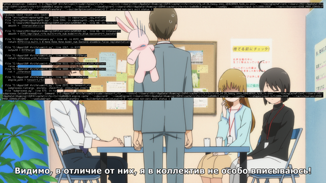

Thanks for response! But I've got error after replacing files.
https://i.ibb.co/Jj2KgBRM/1.png

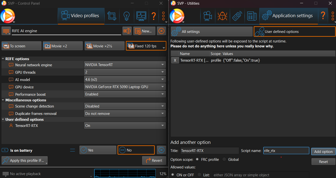

I also did what you suggested: generate.js is no longer patched. TensorRT-RTX is
now switched on with a "rife_rtx" user defined option. How to enable it:
1. Close SVP and any player, back up the SVP 4 folder.
2. Copy the "SVP 4" folder from the archive over "C:\Program Files (x86)\SVP 4"
(needs admin rights once).
3. Start SVP, then main menu -> Application settings -> "User defined options"
tab, fill in the fields below and press "Add option".
Title:          TensorRT-RTX   (any text, it is just the label)
Script name:    rife_rtx       (this exact name matters)
Option scope:   FRC profile
Allowed values: ON or OFF
4. Open your RIFE profile. At the bottom there is now a "User defined options"
section with a "TensorRT-RTX" row: set it to On. "Neural network engine" must
still be "NVIDIA TensorRT".
5. Play a video.
The second attachment is a screenshot of both places: the option being added on
the right, and the "TensorRT-RTX" row set to On in the profile on the left.
Off is the default and gives exactly stock SVP behaviour, so the option is safe
to leave in place.
