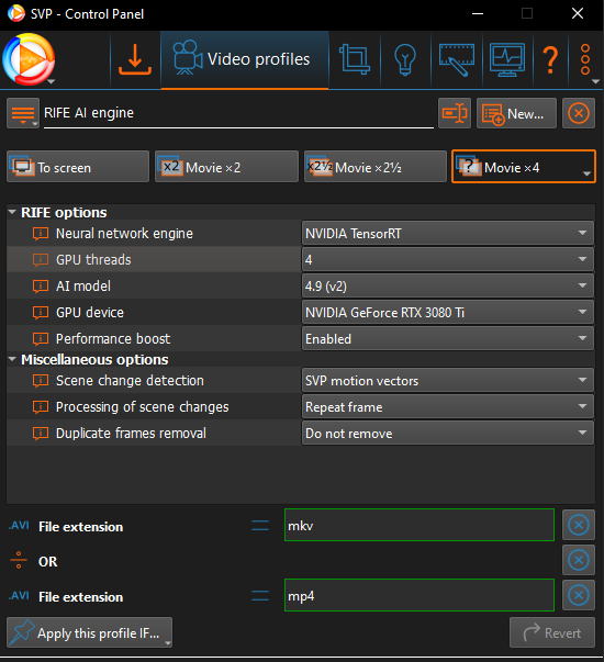

I have been using this setting to play all of my anime these days, its been great for me, but can it get any better?
Should I change my AI model to 4.26 Heavy?
Any suggestion?
I'd suggest trying 4.22 Lite and 4.25 Heavy. Both are good quality-wise but while 4.25 Heavy is slightly better, it comes at a very high performance cost. 4.22 Lite has become my default.
With 4.26 models, I've experienced some pretty bad artifacts, so would not recommend. YMMV.
