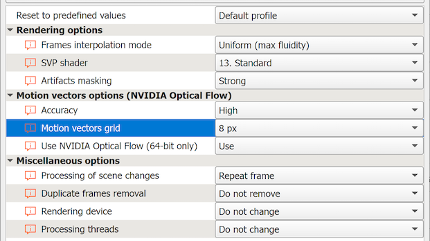

dawkinscm wrote:brazen1 wrote:dawkinscm wrote:I hope so because while RIFE is still the smoothest the few remaining artifacts were horrible. In my testing I was able to remove every RIFE 25/26 artifact from all my test scenes using SVP. But if the new 26 heavy can remove those artifacts too then I'm there. I'm still impressed with what SVP can achieve though and if the new 26 heavy isn't that much better then I have no issue using SVP with LSFG
