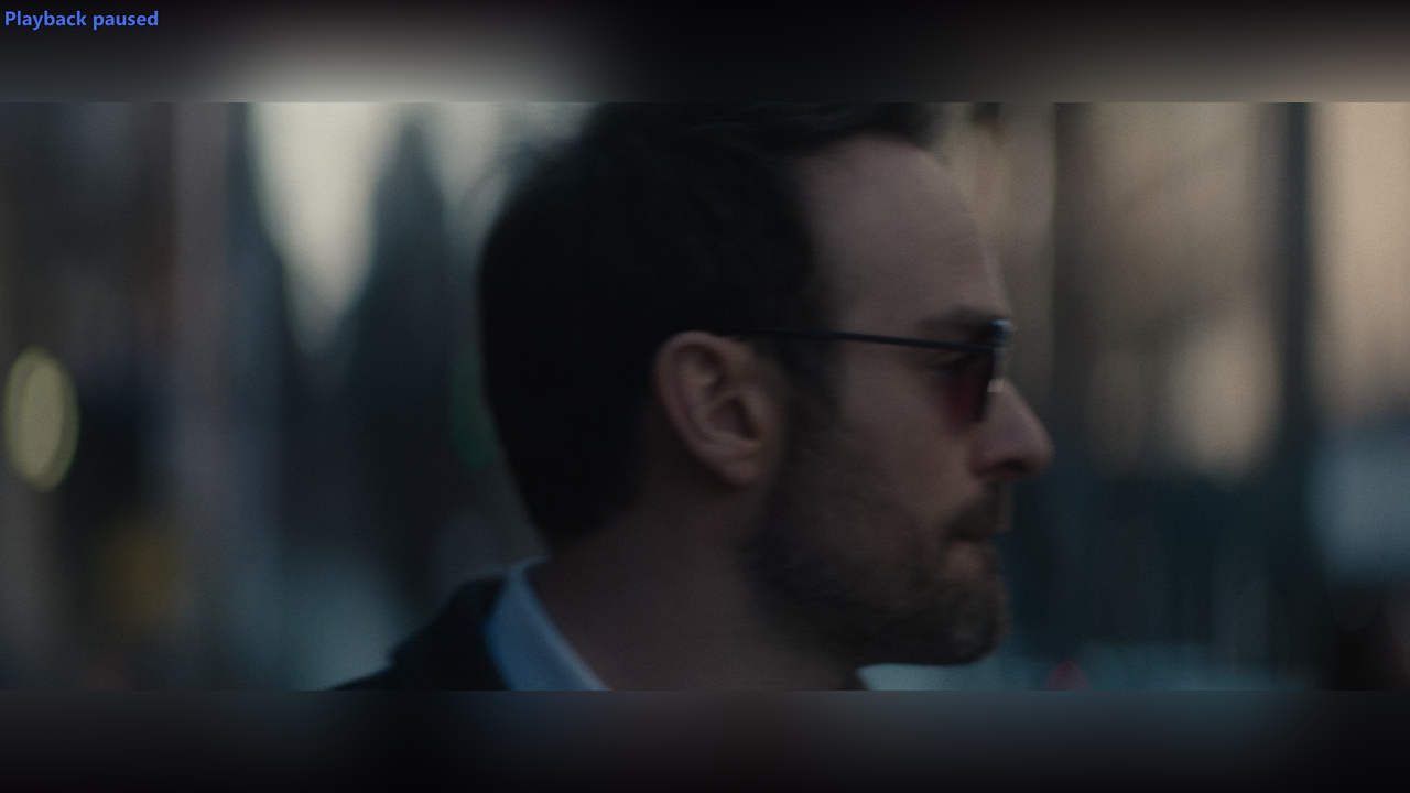

I don't know why but I always get stutters when playing DV files with SVP RIFE, no matter the player, decoder or video renderer, and it's not because the GPU or CPU usages are maxed.
And the weird thing is that they are always in the exact same place.
For example in this little sample video ( https://drive.google.com/file/d/1nul0-B … sp=sharing ), I always get a visible stutter at 00:00:11, just at this exact place:
https://i.postimg.cc/PJqq8m0J/image.png
Can you test if this also happens to you, at this exact point, or is your playback perfectly smooth?
2,461
narkohol
SVP repeats frames at the points where DV color data changes.
There's no way to "interpolate" DV frame colors and meta data, which can be completely different in adjacent frames even inside single scene.
2,462
narkohol
Ah, damn it. I was going crazy thinking something weird was wrong with my system.
Sure there isn't any possible way to fix this? for example this isn't a problem using LosslessScaling interpolation, but of course, its quality isn't as good as RIFE and despite being perfectly smooth it shows more artifacts.
2,463
nope. pixel colors are different in an adjacent frames.
colors get fixed at the rendering stage only, by applying DV metadata to the pixel colors.
and SVP works _before_ rendering
