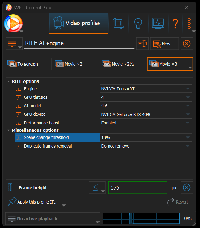

Maybe I should change something there or maybe install different a different interpolation algorithm, Im using the default one. I currently have this
Screenshot 2023-04-17 085748.png, 64.31 kb, 647 x 737
4 (edited by cemaydnlar 17-04-2023 18:39:33)
Re: Plex HTPC and MPV RIFE AI not performing as expected RTX 4090?
Can you please try to set the maximum thread from additional options-processing threads. Also delete that frame height setting from the cross on the right.

6 (edited by AutoClickers 17-04-2023 20:42:33)
Could you please send link to a picture of what that’s is or elaborate further? Or are you simply talking about changing the gpu threads from 1 to 4? I’m having a hard time finding it :c

8 (edited by AutoClickers 18-04-2023 07:13:01)
Unfortunately, it made the situation worse so I resorted back to Auto. I tried manually setting the threads and realized that Auto probably does a very good just using the correct setting.
Disabling GPU scheduling kinda worked. It shows that it's doing 0.97-1 but it drips below that and then continues stuttering. I probably need like 2% more GPU power for it to work lol

13 (edited by Fortune424 19-04-2023 21:07:51)
AutoClickers wrote:
aloola wrote:
AutoClickers wrote:
I tried using 8 threads but it the same performance as Auto so it looks like the Auto option is working correctly. Could you please link to where I can find the downscaling options just to check?
https://www.svp-team.com/wiki/Manual:Resizing
I couldn't find a way to set a specific resolution, only change it to HD. I think the big issue I have compared to other people is that one of my ram sticks broke so I'm running my PC with a single stick of ram and what I understood from the thread is that ram matters a lot. I'm currently running a single 6000mhz ram module with a 7700x, and getting 0.95 from the graph. I'll update when I decide to go into my pc and either fix the stick I have or add another stick.
That could be the problem, although DDR5 kind of has 2 channels built in so it was a much bigger deal with DDR4.
I haven't really tried it but this is how you would set a custom resolution to downscale to:
Open the advanced settings, where it says -12800720 put -25601440 or whatever. Personally that seems silly to me though and I'd rather do x2 at 4K than x3 at 1440p, especially if your screen is 60hz.
https://i.imgur.com/l4c6qmH.jpg
Fortune424 wrote:
Yeah I tried it but ultimately decided that the quality tradeoff was not worth it. I also did find that forcing dx11va in mpv improved performance so for the people who are reading this thread later try that if you want to squeeze a little extra out of your GPU.
