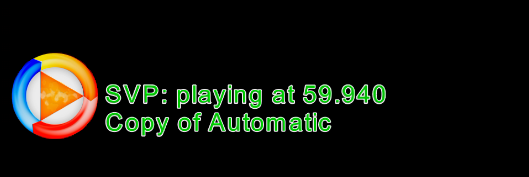

SVP is not working on my laptop. But it's working on my desktop and I'm trying to compare what is different.
I have
* PotPlayer version 201209,
* SVP version 4.5.0.200
* Windows 10
When I run video, SVP logo is not appears on video screen, but the tooltip on tray icon shows that SVP playback is running. SVP Index graph is showing N/A and in the log there are these rows
Laptop log - SVP does not work
13:11:43.588 : PotPlayer: found new player instance
13:11:48.951 : PotPlayer: new video in PotPlayerMini64.exe (64-bit) [PotPlayer 0.0.0.0] on screen 0 using Avisynth engine
13:11:49.036 : Media: video 1920x1080 [PAR 1.000] at 23.976 fps
13:11:49.036 : Media: codec type is AVC, YUV/4:2:0/8 bits
13:11:49.038 : Playback: starting up...
13:11:49.047 : Playback [30a62d02]: Frame server (64-bit) 3.5.0.0, AviSynth+ 3.5 (r3106, 3.5, x86_64), C:\Windows\SYSTEM32\avisynth.dll
13:11:49.049 : Playback [30a62d02]: resulting video frame 1920x1080
13:11:49.050 : Playback [30a62d02]: 2 acceptible profiles, best is 'Copy of Automatic' [0]
13:11:49.053 : Playback [30a62d02]: enabled while video is playing
13:11:49.060 : Playback [30a62d02]: playing at 59.94 [23.976 *5/2]
13:11:49.061 : Playback [30a62d02]: frame transformations are disabled in this video player

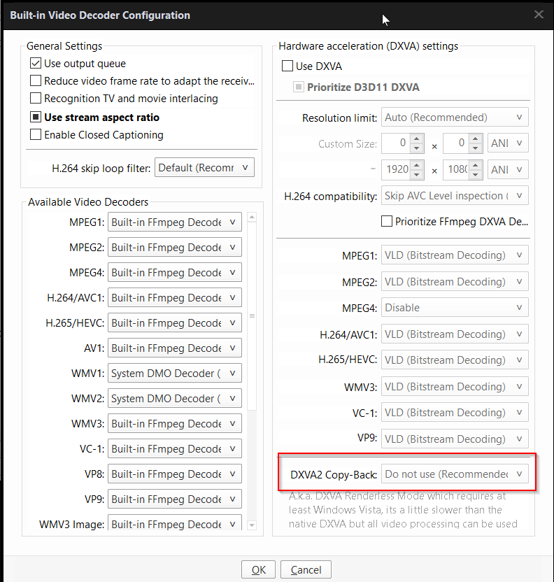

Re: SVP in PotPlayer native mode
https://www.svp-team.com/wiki/SVP:Daum_PotPlayer
Click Built-in codec/DXVA settings and in the window opened check Use DXVA and Use DXVA2 Copy-Back Mode

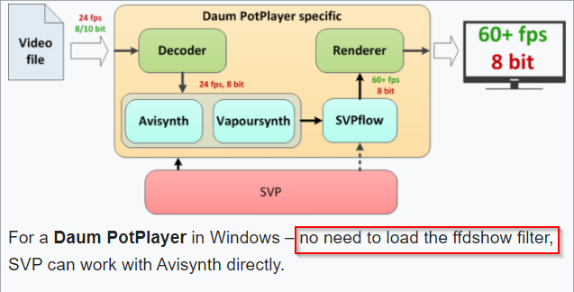

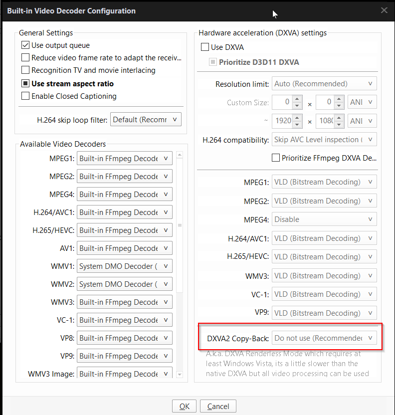

Thank you for quick reply. Actualy these 1 and half year I've tried to get SVP work with FFDShow filter as is described in the page which you linked. But it doesn't worked. What I could reach is that it's work for about 10secs than the video and audio desynchronizes and it's all. I went through the forums, tried many options (other media players and so...). I really worked with it long long time and at the end I gave up all hope that it will works. But recently I saw that you have information that the pot player doesn't need the FFDShow filter. It's here
https://www.svp-team.com/wiki/Manual:SVP as you can see it in attached picture. When I saw this I changed SVP to native mode on my desktop and it works much better than with FFDShow filter. So I hoped that it will work also on my laptop, but it does't work.
I'm thinking that the Potplayer setup wiki page is obsolete when it's showing that you need to configure FFDShow filter while your newer page is saying that "no need to load ffdshow filter"
PotPlayer can work either via ffdshow OR via "direct interface". In both cases the video decoder must be set to "copy-back" mode.

For me it's working without copy back mode on the desktop, see the screenshots
because you have hw decoder completely OFF
obviously dxva decoder modes are only valid for the dxva decoder

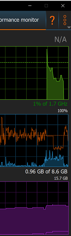

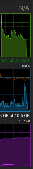

Oh I'm sorry, I also figure it out, that on my desktop it's the DXVA disabled. Even I copy my settings between desktop and laptop this is still different.
Anyway now I tried many options from the DXVA copy back dropdown (on laptop). But the SVP index dropping very quickly it's almost the same when I set the SVP parameters higher or lower and the CPU is not loaded so much on higher or lower settings.

Where can I look to find a culprit of this behavior?
the orange line is the CPU frequency. if it drops so heavy under not-so-high load then blame your laptop's manufacturer big_smile
I do not understand why should stay CPU frequency high if the CPU load is very low (cca 20% as in picture). Can you please elaborate?
usually if a laptop drops frequencies and SVP index that means overheating, CPU throttling, etc.

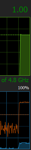

I reconfigured my system that it will not drop the CPU frequency, but the result is similar (see attachment). I also look on the CPU cores load and all cores are loaded - it means it's not like only one core running on 100%. My CPU is i7-8750H 2.2GHz
