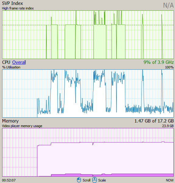

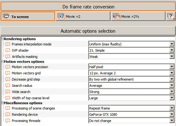

I'm having performance issues on Windows 7 x64, using SVP4 v4.1.0.114 (registered).
When I was using SVP3, the video looked a lot smoother. For some reason, when I run the video player in a small window (about 1/4th of Full HD size), the video seems smooth and fluid. At full screen / big window, it seems jerky and feels like 24/25fps despite SVP telling me it's going at 59.something FPS.
It worked fine w/ SVP3 w/ big source files. The same source files now produce jerky motion.
I have an AMD FX-8350 CPU, and GTX-1080 for the GPU. I have 3 displays, but usually only use the central one with the other 2 disabled (I use them only for full-on coding sessions, really).
As I look at my Performance Monitor, I can see SVP Index fluctuating between 0.99 and 1.01. Memory is at about 1.5GB, and CPU in Overall mode seems to be varying between 75% and 89%.
Please advise as to what I could do to improve my video fluidity.
Lately I've been doing "Alter video frame size" => "Decrease to HD", and it helps. I'd like to watch 1080p content in 1080p, though.
I'm probably doing something wrong, but I'm not aware what.

Time to move to x64 mpv (maybe win 8..win10 ? its really good). Shouldnt be a problem for you. Also dont forget to overclock CPU. One of my machines runs FX6300 @ 4.8 and its enough for smooth 1080p experience.
PS grid 12 + global refiment is too much for your cpu. Try to increase grid
