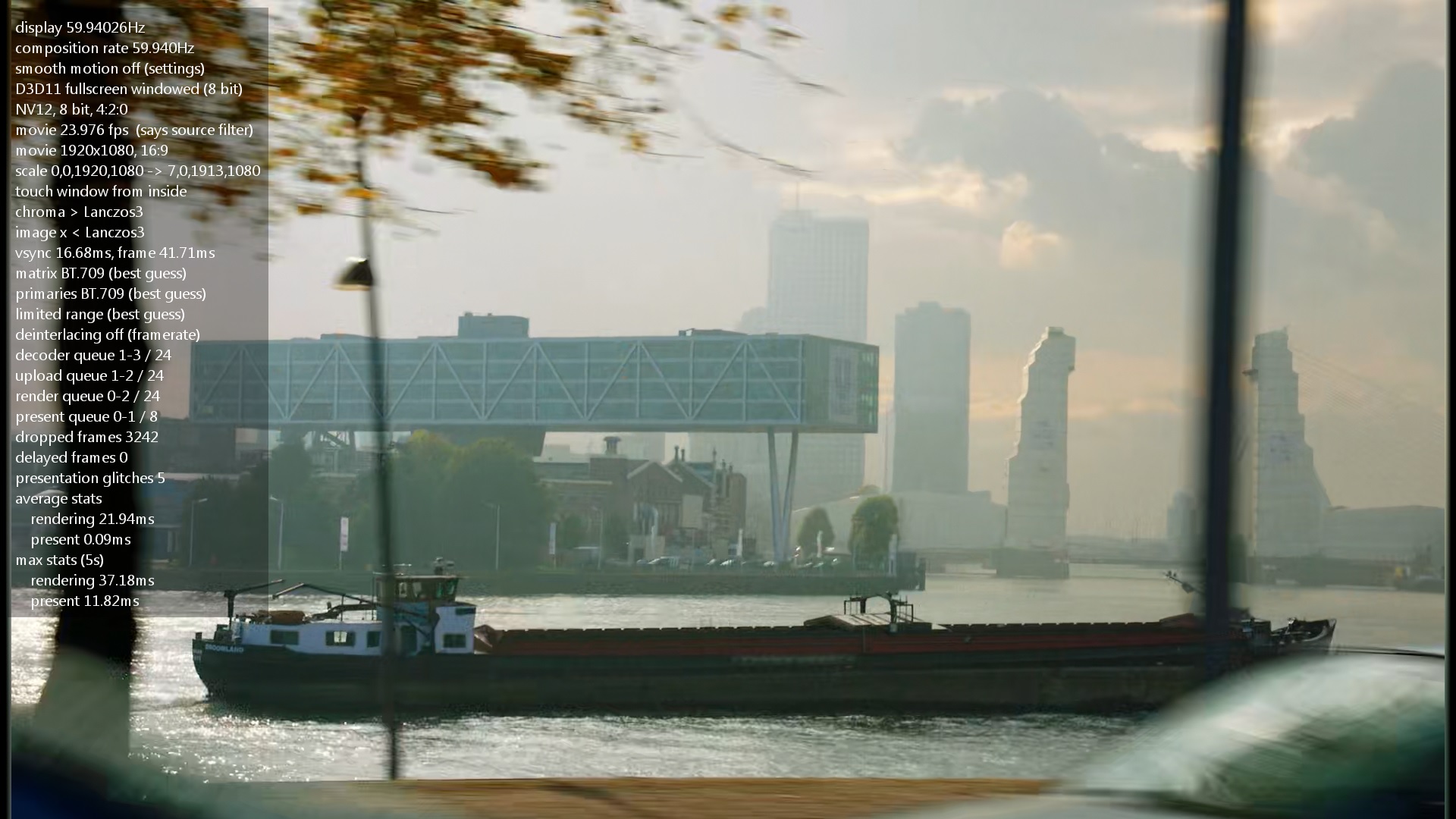

I have recently upgraded my pc, swapped my hdd for sdd and since reinstalling svp I can't get it to work.
Specs:
i5-3570k running at 4.ghz
Radeon r9 290 4gb gpu
12gb RAM
I installed the bundle -mpc-hc,avisynth,ffdshow,reclock,madvr ( got the correct version for my mpc-hc 32 bit)
Added the ffdshow raw video filter and set it as preferred
But all my videos lag a good few seconds behind the audio.
Things I have tried:
Adjusting reclock settings
Lowering madvr settings
Disabled "use direct3D" in madvr
setting svp to higher perfromance
disabling gpu acceleration
using EVR instead of Madvr
I have also uninstalled everything, ran ccleaner and done a fresh install, incase any old settings files where causing the issue.
But no matter what I do the video lags and frames are dropped.
Not sure what all would be helpful for me to upload to this post, but i've atached  a screenshot with a frame dropped readout and the list of active filters.
*Edit image of active filters was too large to attach so ive uploaded elsehwere, hope the links ok
https://i.imgsafe.org/6a382510cf.jpg
Apologies if im missing something obvious, last time all I had to do was install and run and it worked fine.
Thank you

Hi, I don't use MadVr anymore but I used to. According to your screenshot, your vsync is 16.68ms whereas your average rendering time is 17.52ms, which, if I remember correctly, is too slow and will cause frame drops, choppy play, etc.
Average rendering time needs to be below 16.68ms, I believe.
Beyond that, you might try using PotPlayer, which is what I use (the 64bit version, works perfect without ReClock).
