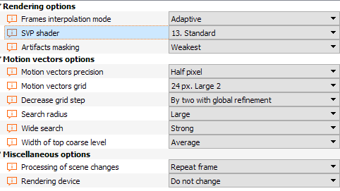

I've done a lot of tinkering and found that these are the best settings for anime. You do get a little bit of artifacting around moving objects occasionally, but I find that easily ignorable and well worth the tradeoff. These settings are quite demanding for some anime, they do tax my system which is an overclocked i5-6600k and 980 Ti.
I've actually found that complicated shader is worse in most circumstances, it can cause panning shots to stutter and other weird effects.
You are only working with exact multiples, right? (x2, x3, x4, etc).
Also one thing to keep in mind is that, for whatever reason, the complicated shader has fewer artifacts when GPU acceleration is turned off (more info).
Yep.
