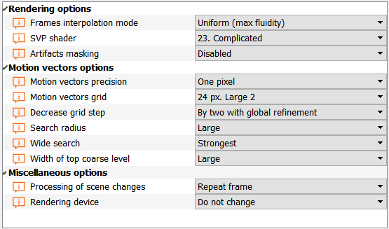

Currently the following settings are best for me,
super_params="{pel:1,scale:{up:0},gpu:1,full:true}"
analyse_params="{block:{w:32,h:32},main:{search:{coarse:{distance:-12,bad:{sad:2000}},distance:-8},levels:3},refine:[{search:{distance:-6}},{search:{distance:-4}}]}"
smoothfps_params="{rate:{num:5,den:2},algo:23,mask:{cover:80},scene:{mode:0}}"
Compare with other settings,
http://imgur.com/a/mjDjs

I too would appreciate it if you could list what these settings mean in the GUI.
Re: How Do I Get The Best Settings
> heck, I don't even know!
yeah, me too big_smile
however this's the UI settings closest to the above script values
svp-settings-61292.png, 14.67 kb, 555 x 327
I wouldn't be surprised if the OP hasn't a clue what settings that script corresponds to; heck, I don't even know!
How do I get around to using these script? Would very much appreciate it, if you shared the instructions.
> Wow, that looks great! Now how do I use this script? XD
I have the same settings as Chainik's post, and edit SVP 4/script/overrride.js
levels.full                = true;
analyse.main.levels            = 3;
analyse.main.search.distance        = -8;
analyse.main.search.coarse.distance    = -12;
analyse.refine[0]            = {search:{distance:-6}};
analyse.refine[1]            = {search:{distance:-4}};
YES thanks! I added these settings and they really help make things smoother and it lessened the squiggly lines!
You edit the override.js file and add them, make sure to take ownership of the file, if not just save the file to your desktop after editing and then copy and replace the old file in SVP 4/script/overrride.js
