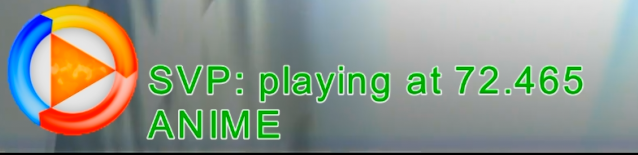

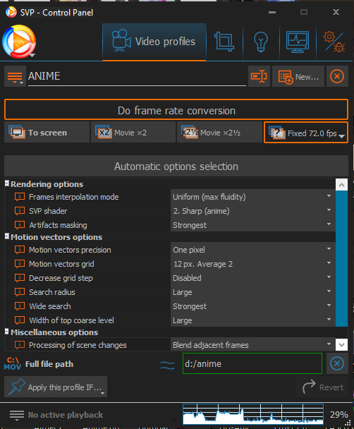

I am experiencing slight stutter every few seconds and its very annoying. i am running on 71.929MHz but in the SVP info shows it as 72.465 and I think, this might be the problem and was wondering if someone could help and solve this stupid issue, so I can enjoy anime again?

What happens if you set SVP to "To screen" instead of "Fixed 72.0 fps"?

I am sorry I didn't mention that, as I forgot. But when I do set it to "To screen" instead of "Fixed 72 fps" my frame rates keep rising at a ridiculous speed. Like it goes from 72 to 100-500 and then comes down slowly and that might actually be the real reason why I am experiencing stutter in first place, because it even happens when I am at "Fixed 72fps" as well as the issue with the video running at 72.465 instead of 71.928, which is what I have my monitor set on.

Well then, what happens if you set SVP to "Movie frame rate x3"?

Taught it was for movies like live action, real time shows and not animation. However, after trying it out and testing for 20 minutes it was super smooth and didn't see any stutter at all. Still, the issue with the frame rates changing constantly is not gone and still appear after few minutes into anime or movies. when I try to skip some few second into the video it shows up quicker. The frame rate appear as 100 sometime maybe up to 500 and then slowly goes down.

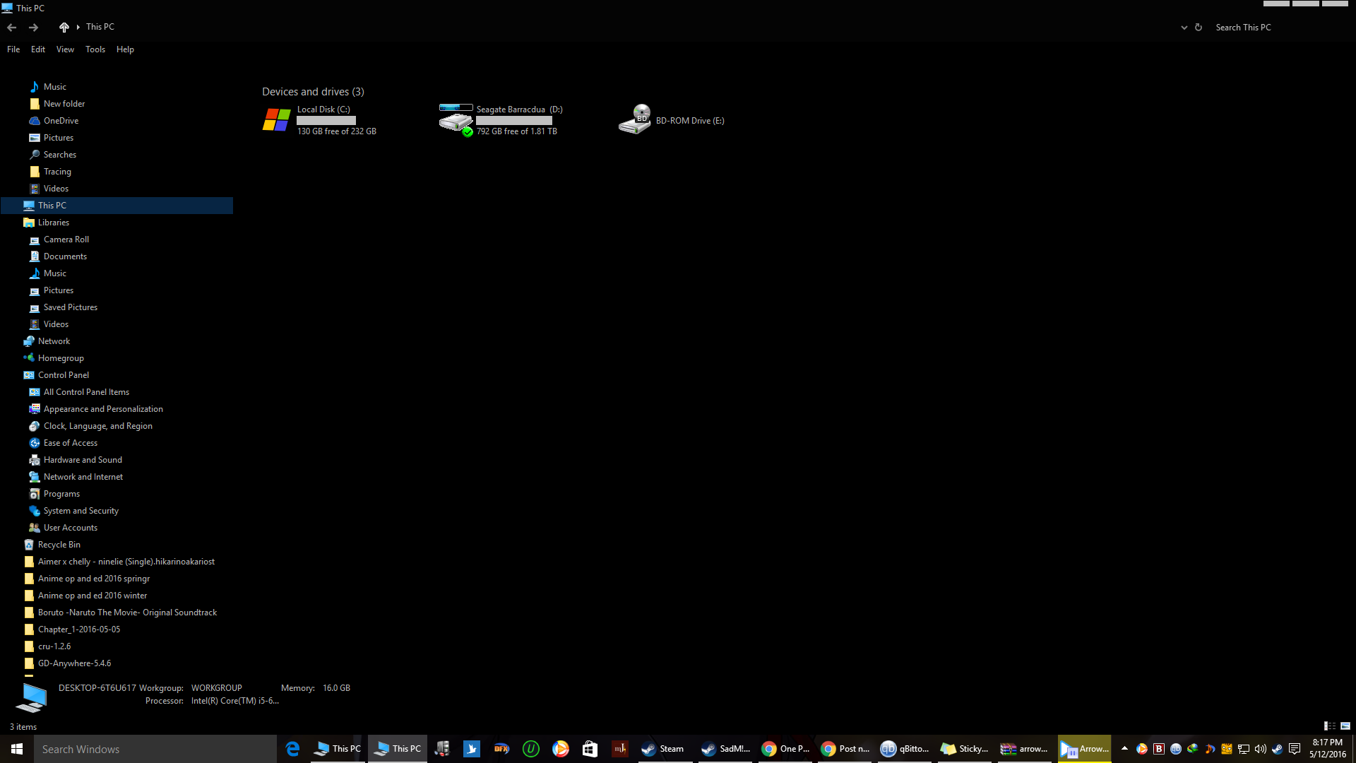

Hey, I'm dumb and this is a completely off-topic question, but what Windows theme is that in the screenshot in the first post?
Nah, you are not dumb for asking. Anyway this theme I am using is for the whole windows 10 system UI, also meaning apps and software, which I like. If you want it I can give you the links, but beware that if you do the instruction incorrect, you will most likely mess up Windows and would need to reinstall it.
Here is another example, it looks very cool, and its easy to setup, at least I think so, but you can mess up your system, so beware.
