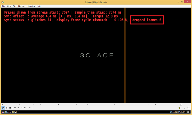

Try EVR Sync renderer in MPC-HC x64.
menu View - Options - Output - Sync Renderer with D3D Fullscreen option enabled.
Ctrl-J to switch statisics details. See dropped frames number. It can grow at start but must stay unchanged while playback.
Ctrl-Win-T to enable/disable SVP tearing test (orange line). Use it to control smoothness
Ctrl-T to enable/disable MPC-HC tearing test (red double line). Use it to control smoothness
