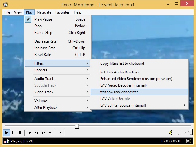

Cinder
Check, if ffdShow is correctluy loaded when playback.
Open video file MPC-HC, then menu paly - Filters. Do you see ffdShow there?
If not then you need to setup MPC-HC.
ffdShow.jpg, 93.65 kb, 649 x 487
Re: SVP 4 Pro "No active playback" on Windows 10
Cinder
Yes, FFDShow Raw is in the loaded filters list in MPC-HC, which is making this so strange.
