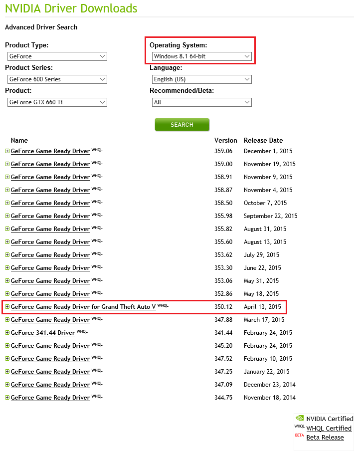

Did some investigations about CUVID decoder+SVP GPU acceleration ("cuvid"+"opencl").
350.12 works to me
14:31:06.054 (I): Video: 1 GPU OpenCL device(s) on NVIDIA CUDA [OpenCL 1.2 CUDA 7.0.0] (NVIDIA Corporation)
14:31:06.054 (I): Video 1: device name 'GeForce GTX 660 Ti' (NVIDIA Corporation, ver.350.12) [gpuID=21]: OK
352.84 is hangs MPC-HC player
14:27:06.425 (I): Video: 1 GPU OpenCL device(s) on NVIDIA CUDA [OpenCL 1.2 CUDA 7.5.8] (NVIDIA Corporation)
14:27:06.425 (I): Video 1: device name 'GeForce GTX 660 Ti' (NVIDIA Corporation, ver.352.84) [gpuID=21]: OK
As I can see OpenCL 1.2 works but only with CUDA 7.0.0.
For download driver 350.12 you need to select Win 8.1 instead of win 10 in the search filter at NVIDIA drivers page.
NVIDIA_350.12_driver.png, 57.05 kb, 718 x 914
