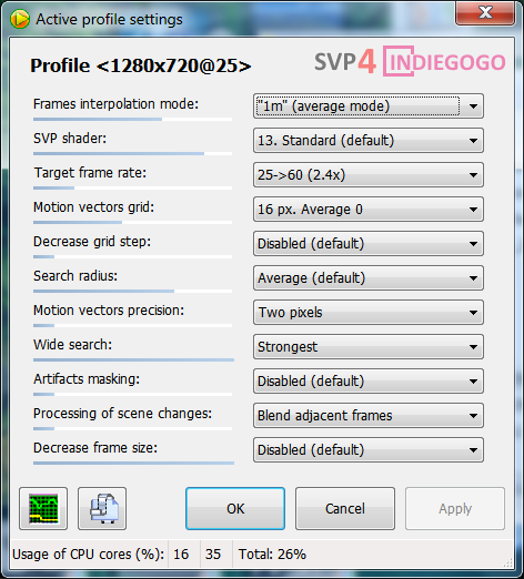

On lower-end hardware (Core 2 Duo without GPU acceleration nor GPU decoding), my customized settings from SVP 3.1.7 seem to be considerably less artifact-heavy.  The movement in SVP 4 feels faster, but due to all the artifacts things actually feel smoother in SVP 3.1.7.
I have no idea how to share SVP 4 settings since they are automatic, but here my SVP 3.1.7 settings are attached.

I made SVP31-script by your picture. See file attached.
Difference is present in 7 places:
1. SVP4 uses 3 threads instead of 7. It is not critical but can lead to jerky playback.
2. SVP4 don't use GPU-acceleration (gpu:0). It can give more artifacts at frame borders and overall.
3. SVP4 uses 28px vector grid instead of 16px. It must give less artifatcs but less smothness.
4. SVP4 uses Average wide search (bad.sad:1000 by default) intead of Strongest wide search (bad:{sad:2000}}). It can give less smoothness of small objects.
5. SVP4 uses Sharp shader for anime (algo:2) instead of Standard shader (algo:13). It gives more visible artfacts around moving objects.
6. SVP4 uses Repeat frame on scene changes (blend:false by default) instead of Blend ajacent frames (blend:true). It can give more jerky playback at fast scenes and at scene changes.
7. SVP4 uses adaptive frame interpolation mode (mode:3 by default) indtead of "1m" mode (mode:1). It gives more smoothness but more artifacts.
So, I see 3 causes wich can lead to more visible artifacts: #2, 5 and 7.
BTW, My lower-end CPU (mobile i3-3217U) gives me more smooth playback and less artifacts with SVP4 and with profile settings by default than if I use SVP 3.1 with your settings.

6 (edited by Nintendo Maniac 64 09-08-2016 18:20:21)
Re: SVP 4 more artifact-heavy than SVP 3 on lower-end CPUs?
Nintendo Maniac 64
Uhhh, so what am I supposed to do with this file?
I'm not using GPU-acceleration in SVP 3 either seeing how the PC in question only has a lowly Intel 965GMA iGPU from 2007 which is low-end enough that it can't even smoothly do 60fps at 1080p in MPC-HC unless I enable "D3D Fullscreen".
And for reference, the iGPU also doesn't support h.264 hardware decoding.
I figured it was something like this.  I noticed while testing various settings in SVP 3 that I can achieve similar settings but that it's definitely more artifact-heavy which I particularly attributed to the low quality shader setting; this is the main reason why I use 1m for my interpolation mode (which also lets me use 16px)
Yeah, maybe lower-end than a modern desktop CPU, but that thing is easily still at least twice as fast as my 2.4GHz Core 2 Duo due to considerably better IPC, SMT, and an iGPU that SVP can actually use and has h.264 HW decoding.
