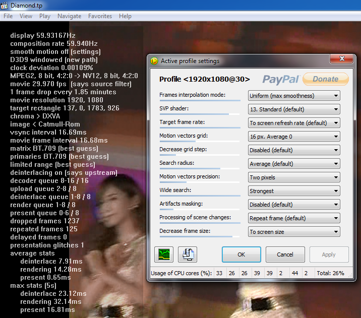

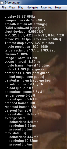

I have some .TP and .TS videos that cause some problems. With madVR alone, it plays normally. With SVP, however, madVR displays weird deinterlacing times that cause the video to lag.
I currently have the latest Catalyst driver 15.4. There are some driver versions that don't cause this problem (at least one driver version that I kept reverting back to).
Here's a screenshot with madVR alone, then with madVR+SVP.
You can download the video here
https://mega.co.nz/#!KYpSlJYD!c4XNTi0jy … cLxWkOvsRA
DiamondMadVR.png, 166.61 kb, 287 x 634
DiamondSVP.png, 394.18 kb, 716 x 631

If you want to watch interlaced video with SVP you need to deinterlace it first then use SVP to insert interpolated frames.
In your case (29.97i movie on 59.94 Hz display) you don't need SVP. Use vector adaptive deinterlace to get true source 59.94 fps from this movie.

With the Diamond video, when I play it without SVP, it does appear to already be playing at 60fps with 29.97 interpolated. It's a fluid 60fps with great quality. So although this driver version causes SVP+madVR to lag, it DOES appear to be doing the right thing.
Whereas before, with a different driver version, SVP+madVR would work properly but the video's quality would be lower. Maybe the interpolation mode was different for some reason to generate 29.97fps instead of 59.94fps.
So when I look at the video information, it says 29.97, and it appears to be playing 59.97 already. SVP is then trying to generate frames with a 2:1 ratio, which is where lags occur.
