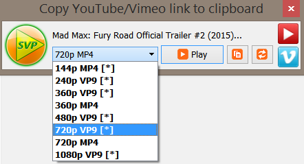

Re: Standalone SVPtube doesn't work with Potplayer and Mpc-HC
http://www.youtube.com/watch?v=vjBb4SZ0F6Q
http://www.svp-team.com/forum/misc.php?item=3442&download=1
svptube-vp9.png, 23.21 kb, 442 x 239
