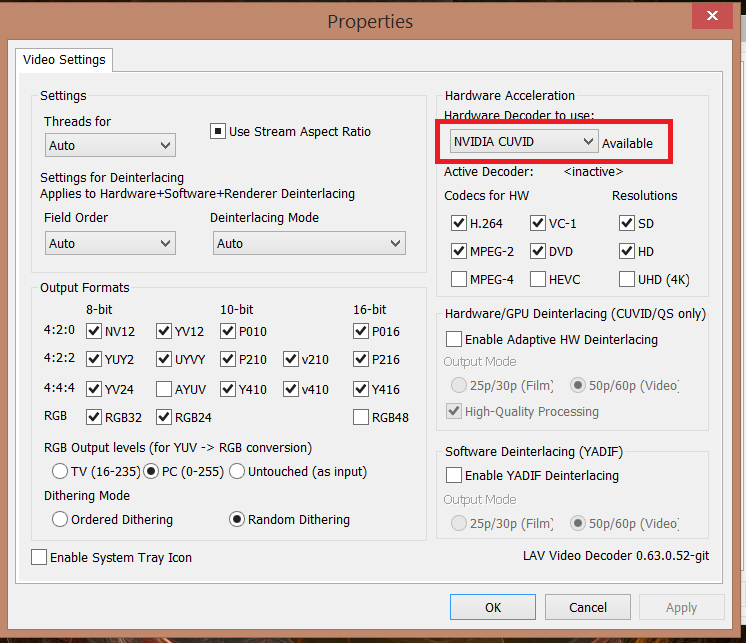

I am also running a EVGA GTX 980, so is there any advantage to what you see in the screen shot as a setting ?
Thanks !  smile

You can ignore ReClock installation. It gives you more artifacts and more CPU usage or regulate jerks. For example read this post.
Did you see hidden setting NoJerksWithoutReClock and did you read comment near it?
(SVP tray menu - Information - Hidden settings)
What real refreshrate has your 59Hz mode?
You can see it in SVP additional information or in renderer info by Ctrl-J
