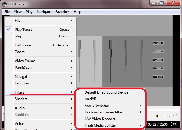

check the active filters in MPC
http://www.svp-team.com/forum/misc.php?item=2922
Безымянный.jpg, 65.37 kb, 600 x 431

One more way to select subtitles in LAV splitter is without icon enabling go to player menu Play - Filters - LAV Splitter
http://www.svp-team.com/forum/misc.php?item=2925
