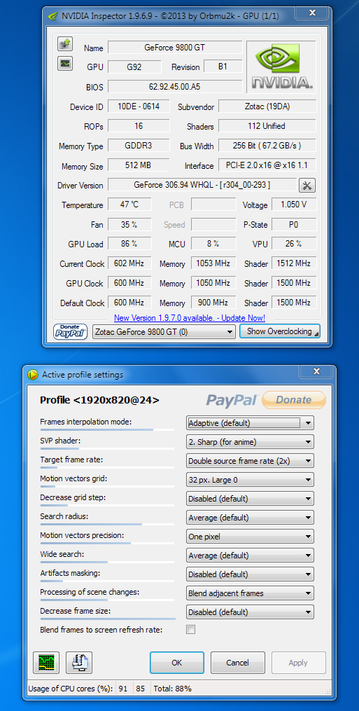

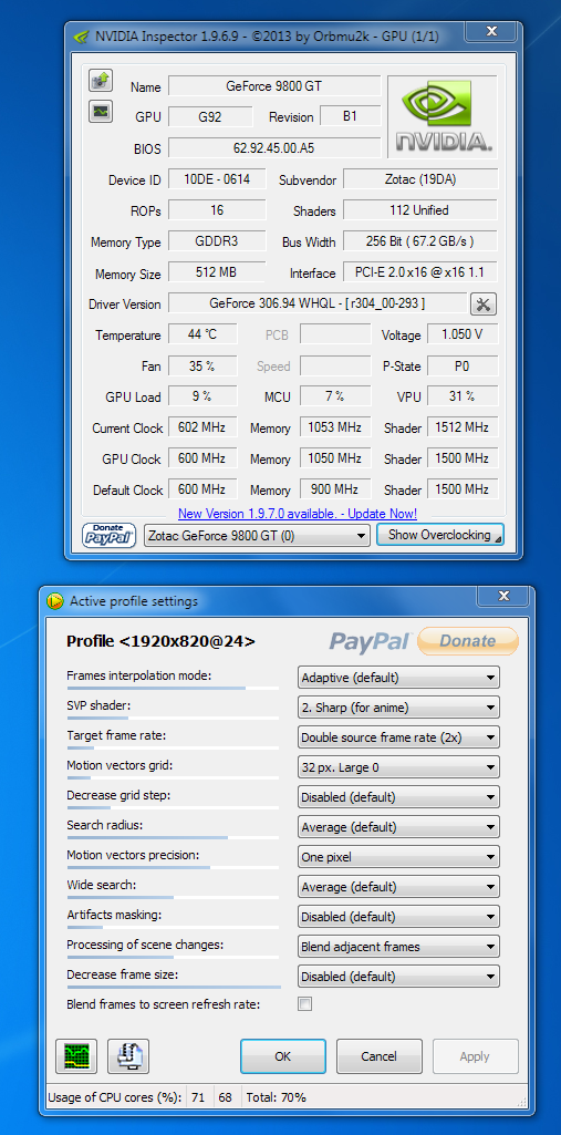

I'm not talking about high CPU load. See:
With a video of nonstandard dimensions: MPEG4 Video (H264) 1916x796 23.976fps, GPU acceleration consumes full GPU power and additional 23% CPU
I'm attaching screenshots so you could see what's going on.
Re: Very high CPU with 3.1.4 in 1080p
qduaty
I see 86% GPU and 88% CPU load. It is critical values. Both devices with that high load can lead to your "slide show".
To reduce CPU load you can change or reset profiles.
To reduce GPU load you can choose lighter SVP-shader and disable bicubic interpolation: remove // from line "smooth.cubic = 0;" and write value zero (0) in file override.js.
I think 1916 px width is real problem for madVR which loads not GPU separately but CPU too.

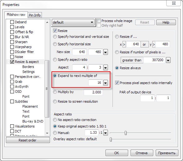

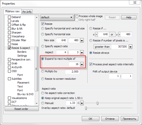

I recommend you two another ways:
1. Crop in AVS-script.
Add code to MSmoothFPS.avs before "input=last":
mult=16
crop(0,0,int(width/mult)*mult,int(height/mult)*mult)
And ajust mult value. It can be 8, 16, 32.
2. Expand framesize in ffdShow to multiply of 16 (or 8, 32).
http://www.svp-team.com/forum/misc.php?item=2396
ffdShow_ExpandMod16.png, 19.01 kb, 590 x 519
