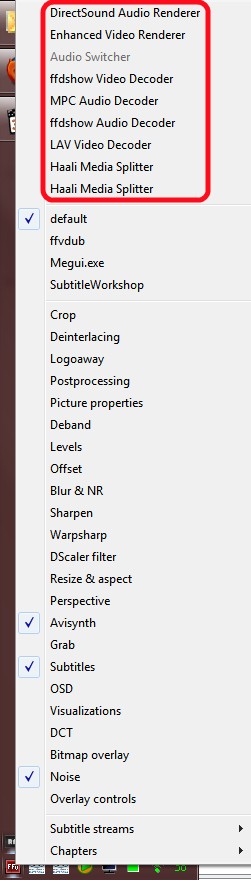

Please, show mediainfo of the trouble file
by the way, what renderer uses in XBMC? did you try to change it to EVR/VMR9R or vice versa?
while playing videofile in XBMC click RMB on the ffdshow raw/video in the tray
http://www.svp-team.com/forum/misc.php?item=2011
Буфер обмена04.jpg, 46.2 kb, 251 x 880
