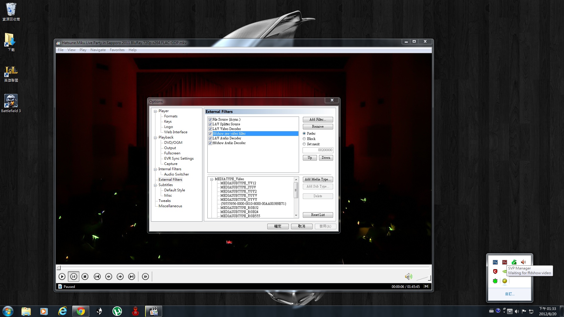

I install everything from SVP 3.1.2 Full and follow the solution in FAQ.
The ffdshow raw video filter works perfectly.
But SVP Manager still tells me "wating for ffdshow video".
How can I solve this problem?
I'm using Windows 7 64bit.

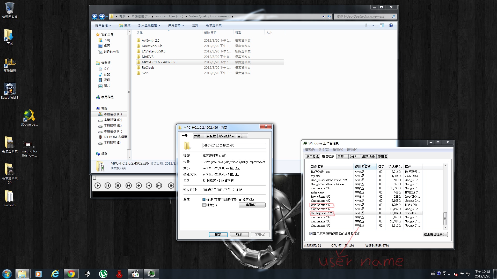

- MPC-HC is a 32-bit version?
- MPC-HC and SVP Manager is running under the same user?
Yes,it's 32-bit version and same user.

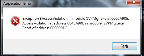

It shows the error occasionally.(see picture below)

I change that.But it doesn't work. Even the error didn't show up again.

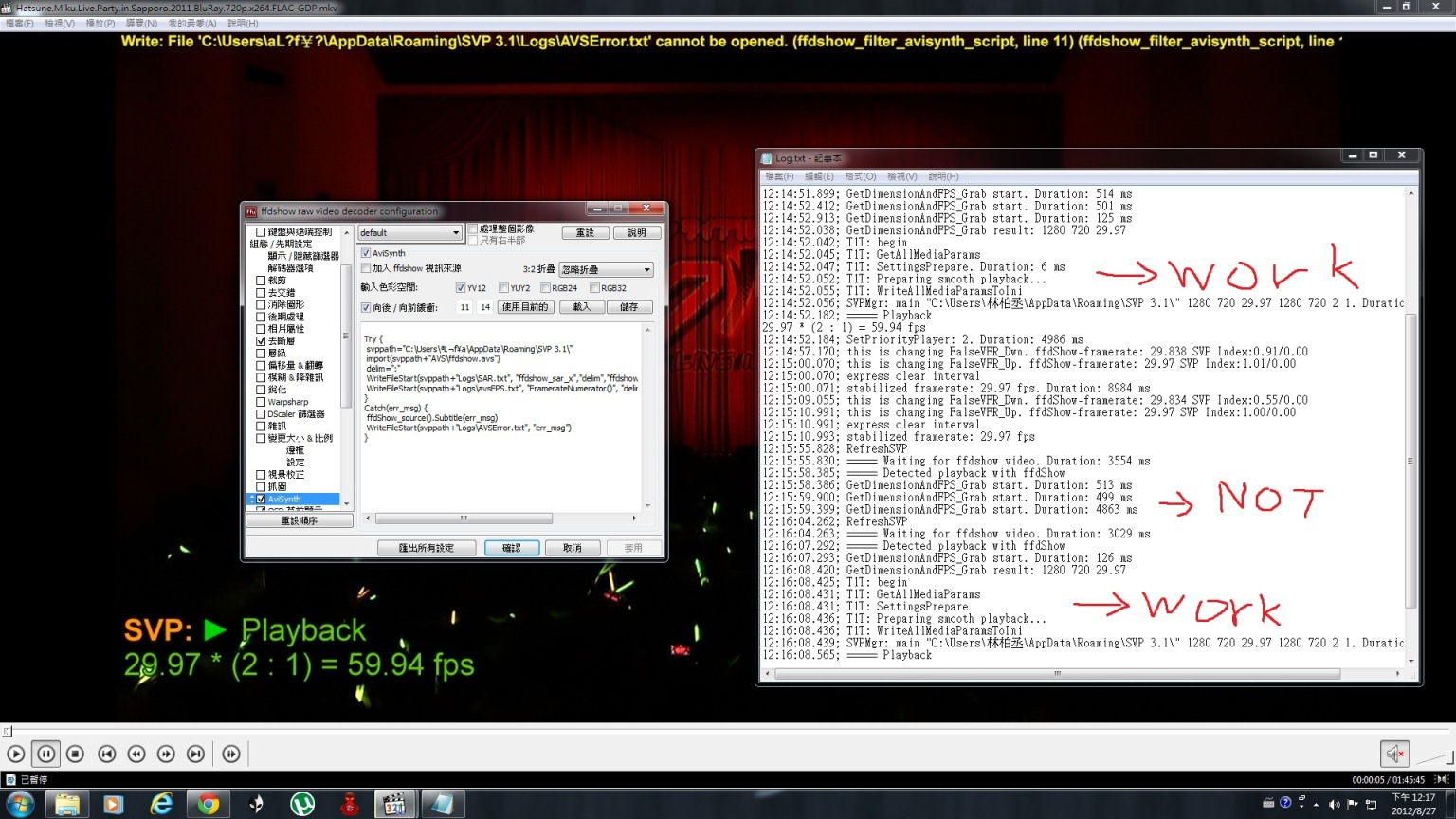

lkk_12342001
It looks like kind of Unicode trouble.
Try to add English-named user and play same video under that user. If it will work I will have to prepare and give you debug version to find and fix this error.
Re: Waiting for ffdshow video (User name in Chinese)
lkk_12342001
Thank you! It works!
The original user name is Traditional Chinese.

林柏丞
Opps! This is the cause! It must be short UTF8 path. Like "folder~1".
Please show log file entirely. I need first two lines where presents Unicode and UTF8 paths.
lkk_12342001
Thank you.
林柏丞
AppDataPath=C:\Users\林柏丞\AppData\Roaming

19:24:19.820; GetDimensionAndFPS_Grab - send CaptureImageMessage 2. Duration: 502 ms
19:24:20.322; GetDimensionAndFPS_Grab - send CaptureImageMessage 3. Duration: 502 ms
19:24:20.824; GetDimensionAndFPS_Grab - send CaptureImageMessage 4. Duration: 502 ms
19:24:21.326; GetDimensionAndFPS_Grab - send CaptureImageMessage 5. Duration: 502 ms
19:24:21.828; GetDimensionAndFPS_Grab - send CaptureImageMessage 6. Duration: 502 ms
19:24:22.330; GetDimensionAndFPS_Grab - send CaptureImageMessage 7. Duration: 502 ms
19:24:22.832; GetDimensionAndFPS_Grab - send CaptureImageMessage 8. Duration: 502 ms
19:24:23.334; GetDimensionAndFPS_Grab - send CaptureImageMessage 9. Duration: 502 ms
19:24:23.836; GetDimensionAndFPS_Grab - send CaptureImageMessage 10. Duration: 502 ms
19:24:24.338; GetDimensionAndFPS_Grab - send CaptureImageMessage 11. Duration: 13493 ms
19:24:37.831; RefreshSVP
19:24:37.832; ===== Waiting for ffdshow video
lkk_12342001
Thanks. Oh! I see.
UTF8 path not created because Unicode path not detected. It is strange. I will change detection algorithm.
Tomorrow will be available debug version #2 of SVP Manager.

I get an error when I try to open SVPMgr.exe
error.JPG, 25.08 kb, 490 x 190
lkk_12342001
The error said that SVP Manager can not find AppData folder with necessary files.
UTF-8 path not work at your system. I don't know why.
Please, show content from file C:\Users\林柏丞\AppData\Roaming\SVP 3.1\Logs\Log.txt
lkk_12342001
The log didn't change anything since I use SVPMgr_UTF8Version.
SVP manger always crash when I open it.
