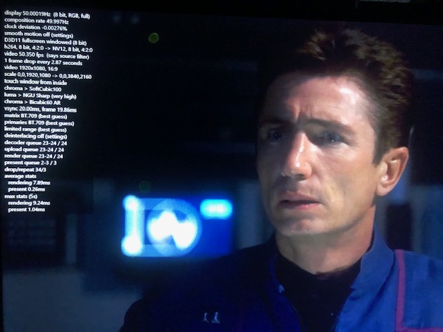

Got it to work at 4k 50hz using MADVR, thank you very much.
does everything look ok from my OSD
the image looks bad because it was taken from my phone
Will SVP support 8k now? or in the future? not using rife
