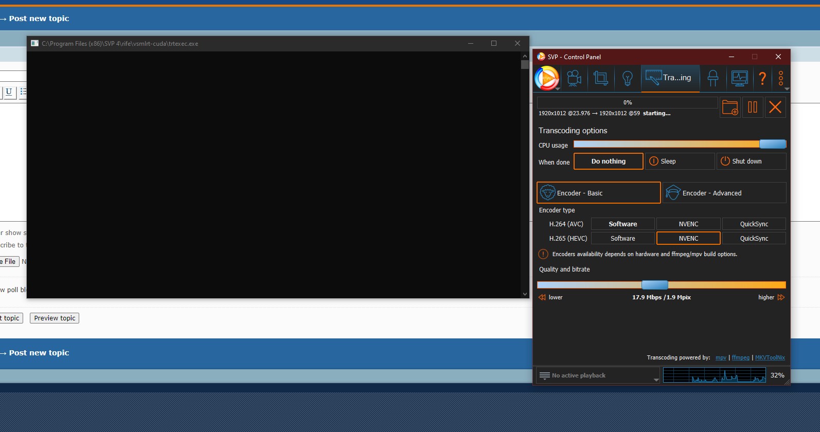

I cant use RIFE, when i select any video file, its says its starting and opens up a cmd window then does nothing for forever... (no cpu or gpu usage in task manager) The screenshot is in the attachment

ps: i also selceted the profile for RIFE correctly with only 2.5x times fps and for nvidia gpu setting
It must be so, but not forever smile
How long are you waiting? Wait for 5 minutes for begining.

It takes 3 to 10 minutes for every aspect ratio change, depending on hardware. So just wait for it.
ONLY the first time of each aspect ratio.
So, what I usually do after a PC format for example is go to a movie or tv show folder, and just run randomly, one at a time, and leave them in the background while I use the internet.
