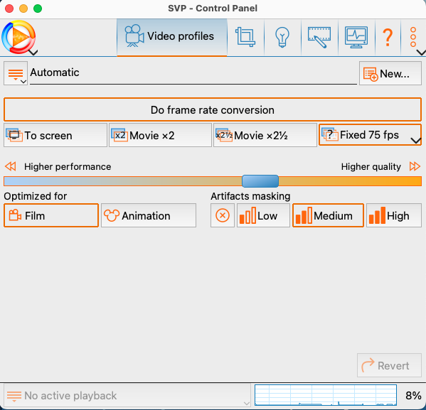

Let me share few details here...
I use VLC latest 3.0.18 along with SVP plugin for VLC.
When I play 1080p or 720p videos SVP can boost the frames in VLC to specified frames by me. (its 75fps in this case)
But If I play 4K videos, there was no effect and the 4K video played in native 24fps.
I tested with more than 10 different 4K files (MP4 and mkv) as well.. vlc did not play it higher fps thru SVP plugin.
Screenshot 2023-03-11 at 8.39.24 AM.png, 64.15 kb, 599 x 577

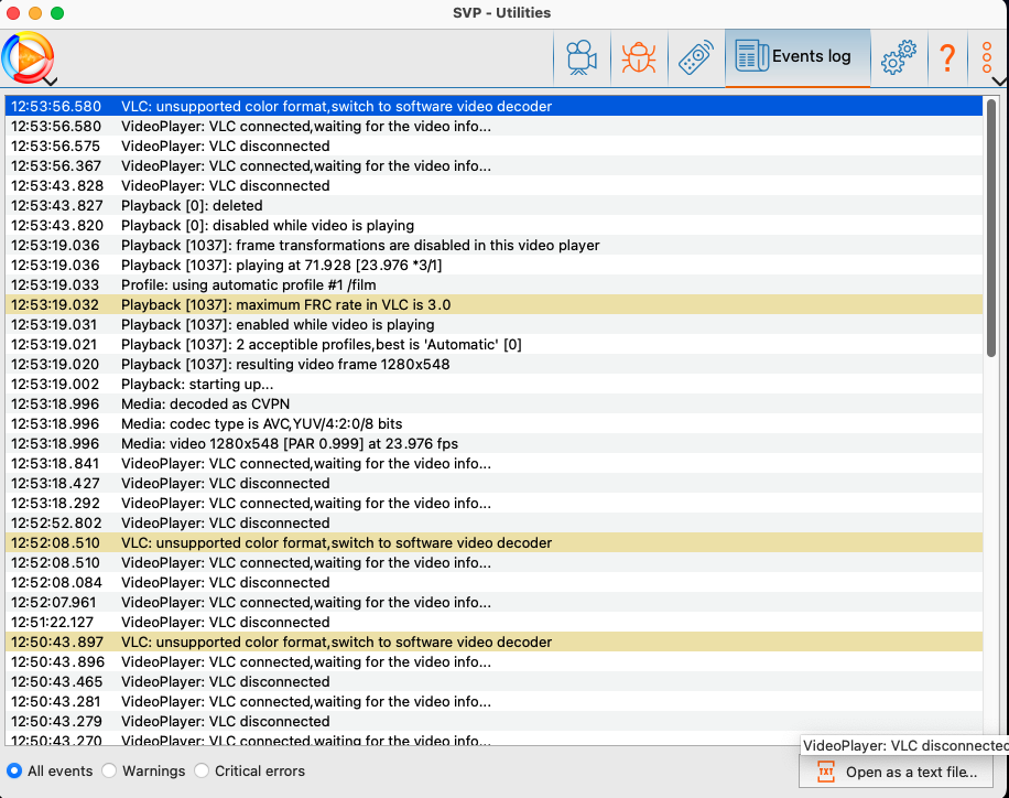

Re: SVP 4 Mac not processing 4K MKV files
Please check message about the cause of it in SVP log:
SVP menu Information > Events log
Probably your 4K video has 24 fps. VLC can increase framerate up to x3. It is VLC limitation. So, use Movie frame rate x3 coefficient ratio or 72 fps target framerate.
5 (edited by vp612 13-03-2023 07:26:23)
When I play 4K videos, I see this error in the SVP log.. unsupported color format VLC. I have attached the screenshot. Please find it here. it occurs with all the 4K files I have (not just an error with a particular media file)
Screenshot 2023-03-13 at 12.54.16 PM.png, 217.84 kb, 916 x 724
then you probably should do what the message says?
@Chainik, could you please help me this error? I am not a techie person.
https://www.svp-team.com/wiki/SVP:VLC
the very first line in the "troubleshooting" section
