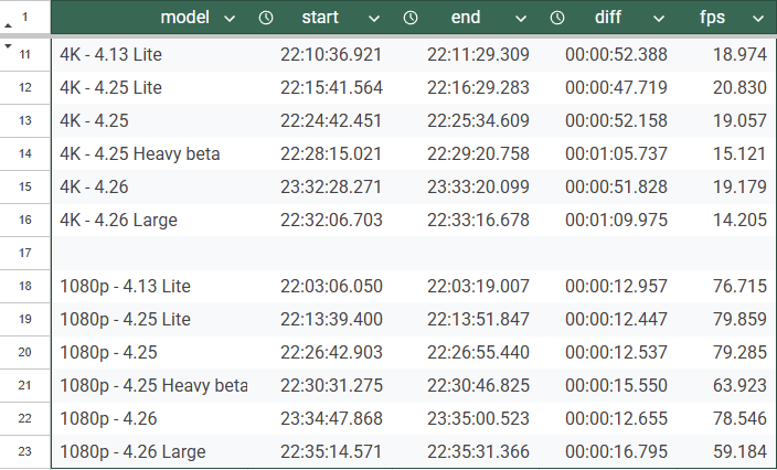

Not sure if this will be useful to you, but I measured performance with the 9070XT. Here are the results for transcoding a random stock video using different versions of RIFE, of course only at x2. Overall, for FHD, that’s more than enough.
RIFE also worked fine on the 5700XT, but the maximum resolution was only about 1520×855. smile
Снимок экрана 2025-11-13 003649.png, 72.15 kb, 704 x 426
