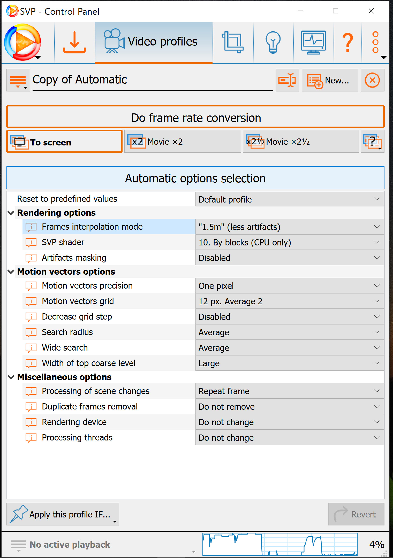

alsoi found this is the best settings for me in terms of no artifacts and smoothness, i cant stand a single artifact, just ruins the experiance so i decided to stick to this.
