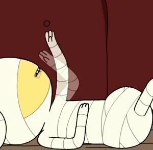

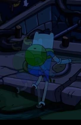

I am using Mpc HC right now i realised that svp constently skips frames so it's looks really inconsenstent and i want it to stop skipping frames please help me with this

Re: How Can I Make SVP Stop Skipping Frames
It is frame blending on hard places.
It is solution to avoid artifacts in cartoons where one frame have a lot of differences from another one.
What you expect in this cases?
i mostly don't care about artifacts  i just want it to interpolate every frame and not skip any
add new video profile, turn off 'automatic options selection', set 'frames interpolation mode' to 'uniform'
i also want it to interpolate even in hard places
Are you sure it's skipping frames and not masking artifacts? Is artifacts masking set to disabled? Uniform + no scene change detection + integer frame rate multiplier should generate exactly what you want.
