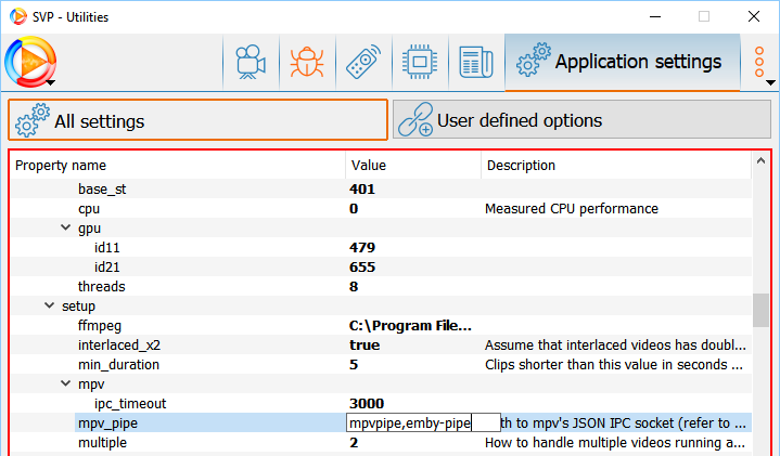

0. Set the very same PATH/PYTHONPATH env variables as for Plex --> run "SVP -> Utilities -> Set environment variables for VLC and libmpv"
1. Replace mpv.exe in %appdata%\Emby-Theater\system\x64\mpv
2. Add emby-pipe into SVP's main.setup.mpv_pipe list, restart SVP
3. Run Emby Theater, open Settings, goto Video section, set Hardware acceleration mode to Auto (copy back)
emby-pipe.png, 31.62 kb, 719 x 421
