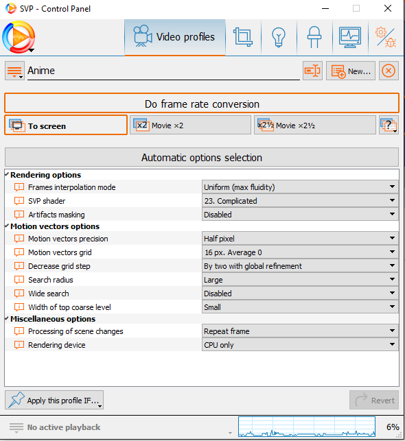

I brought this after seeing a video on it and saw how amazing the anime looked at 60fps but i can't figure out how to get it to work properly.. I've tried searching it up but nothing seems to work.
These are my settings but when i tried it there was a huge audio delay and screen tearing, then when i tried to edit the override.js it stopped showing the video all together and only have audio over a black screen.

profile.png, 36.45 kb, 590 x 643
2 (edited by dlr5668 18-10-2016 12:10:42)
Re: No idea how to use program, how do i make an anime profile?(SVP 4 Pro)
CPU only is very bad setting perfomance wise unless u have this baby
https://lh3.googleusercontent.com/-wXN8eXF026w/WAYQi_ZtRoI/AAAAAAAALkg/9UasKeD_sO0/s0/chrome_2016-10-18_15-07-36.png
I watched few anime shows on this settings:
https://lh3.googleusercontent.com/-QNpQ0dSSQJo/WAYRHvEkixI/AAAAAAAALkk/3rHeqRlEZ_s/s0/SVPManager_2016-10-18_15-10-04.png
Wow awesome, thanks it worked like a charm now for some reason, maybe it was just the Rendering Device, is there any way i can set it up so this will play on VLC instead of the default player it comes with?
