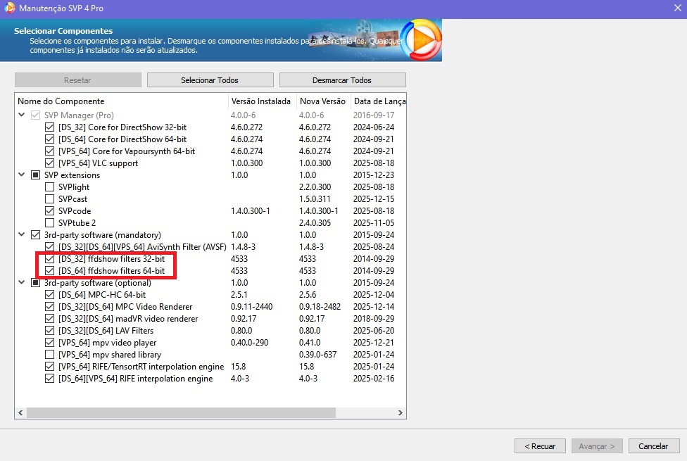

I used the "Updates and features" tool in SVP and added the ffdshow filters as in the image below. Could this be interfering with something?

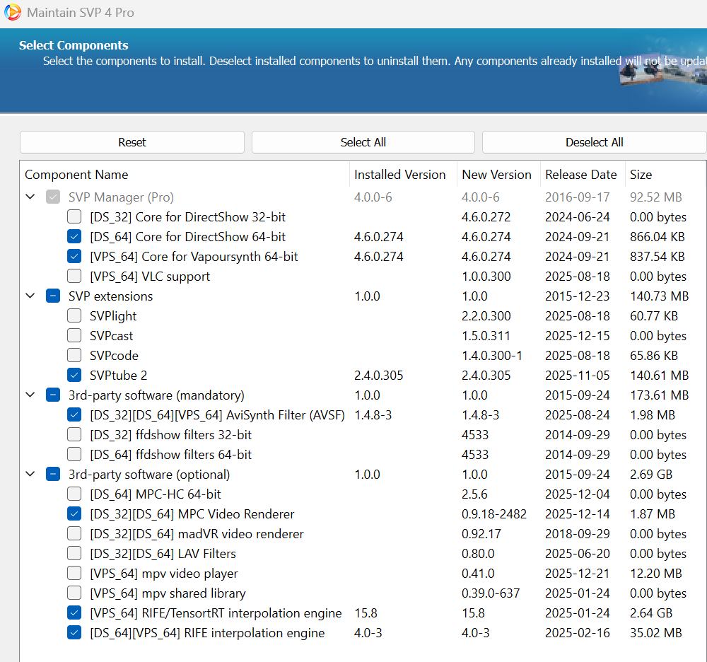

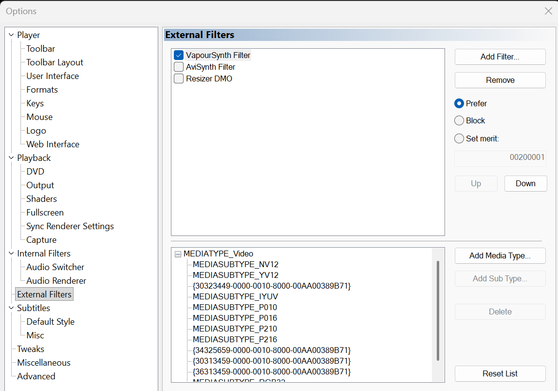

Hello,
perhaps you are using 64-bit version of MPC-HC so you don't need all the 32-bit version of components.
I have only DS_64 and VPS_64 in SVP Manager component section, AVSF in 3-rd party and Rife in optional and MPC Video renderer.
In MPC-HC, I only use VS in external filters and make sure that you have "Prefer" option selected.
I choose "when in doubt, choose only necessary compomenents" approach.

> i tried the ffdshow raw vídeo filter
Don't use ffdShow. Use AviSynth Filter instead
