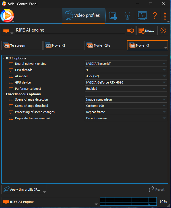

What is the best Anime Setup?
Which Rife Version, mpv config, svp config, etc.?
At the moment i use:
https://www.svp-team.com/forum/viewtopi … 352#p83352
with Rife 4.22(v2) and newest TensorTR library -> v15.2.

My SVP settings:
Screenshot 2024-08-08 212243.png, 53.18 kb, 601 x 732

1,849
Where is the number of pre-prepared frames in SVP set? As I understand it, it generates a parameter for the vapoursynth filter from somewhere, but I did not find where this parameter is set.
My video card can barely handle 3840x1600 video. Loading is 84-100% and sometimes stutters. I think this can be solved by increasing the buffer.
https://ibb.co/37WhcJR
lurker wrote:
pre-prepared frames
concurrent-frames i think is the frc.threads from here:
https://gyazo.com/a12c49b425024e65b789ff0d4a190db8
