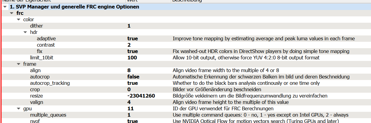

Have you tried setting a different frame.resize limit? I set mine to -23041260 (median of 1080p/HD and 2160p/4k/UHD) and I can watch 4k-HDR-movies at x2 frames on a 4070 with about 80-90% GPU (DDR4, i9 12900KF) using RIFE 4.15v2/2 GPU threads.

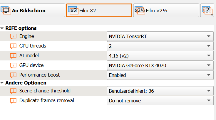

1,336 (edited by abraxas 25-03-2024 14:01:09)
Olombo wrote:
Abraxas: how is it possible you can watch 4k x2 UHD with a 4070? I can not get it running without frame drops with a 4090 and mpc-hc?
I hope the attached screenshots show, that I'm telling the truth (you never know, internet...) - and how I set SVP up. I'm watching The Martian HDR 4K (as I said before, not in real 4K resolution but in the middle of 1080p and 2160p) Edition using MVP with custom shaders.
"Wiedergabe mit" means "Playing at"
