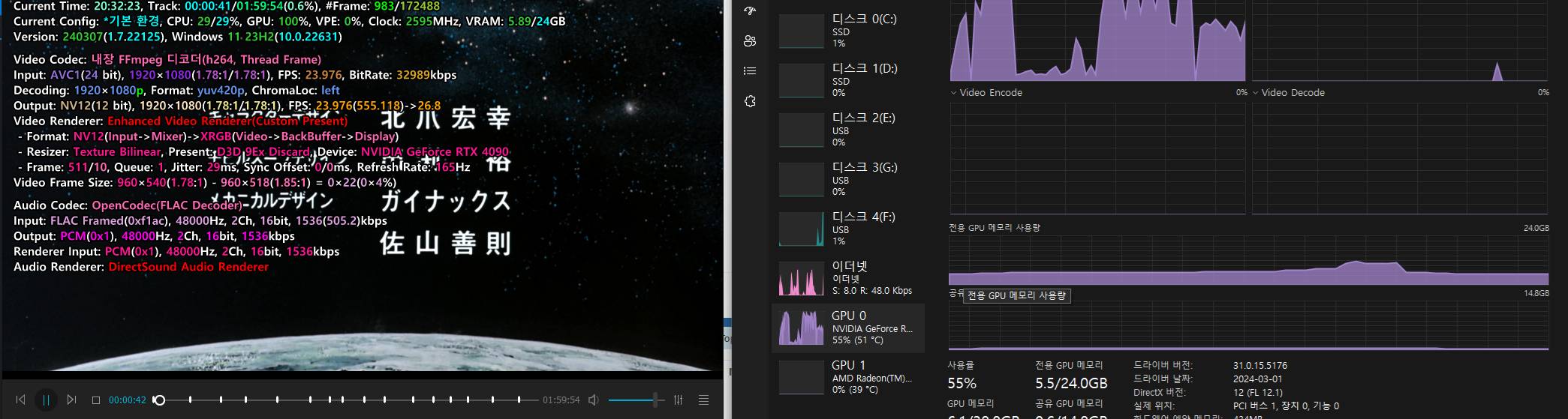

1. Yeah, same issue occurred. But what I find is that the task manager shows aroudn 40~60%, while Potplayer is 99%
2. I know it's very strange at all even it is not solving after format.

GPU has several blocks. You can select CUDA or Compute_0 in Windows task manager to know GPU load when RIFE is work.
