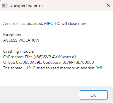

Hi after Update today via svp , my rife+Mpc HC+madvr Broke , now if I play someting on fullscreen freezes
error.png, 11.75 kb, 386 x 352
nothing changed neither in mpc-hc nor rife not madvr recently
Chainik, I have been using that combination for months, without problems. Yesterday, an update for Vapoursynth and some more components appeared via maintenance manager. I uninstalled everything and reinstalled and the problem was not resolved. Please, does anyone know how to solve it. MPV works without problems.
This issue is trigger by enable Direct3d 11 in madvr ,for context that s always setting like that without any problem.
Drakko01 wrote:
Anyone has any ideas on what can i do to fix it ?
Now its crash no matter what. This it's the info of the crash for someone who understand it
