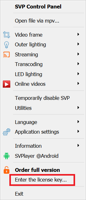

SVP menu Application settings > Additional options > Reset settings to defaults > Yes, but keep video profiles
After that you will see Enter the license key option in menu:
enter_license_key_option.png, 16.6 kb, 276 x 639
Re: How to re-register a device after was removed?
Wasn't showing yesterday, when the key was revoked but showing as registered still.  Appeared today before I came to mention it in the thread.  After yet another off then on of the PC (2nd reboot and day after revoking on the website).
