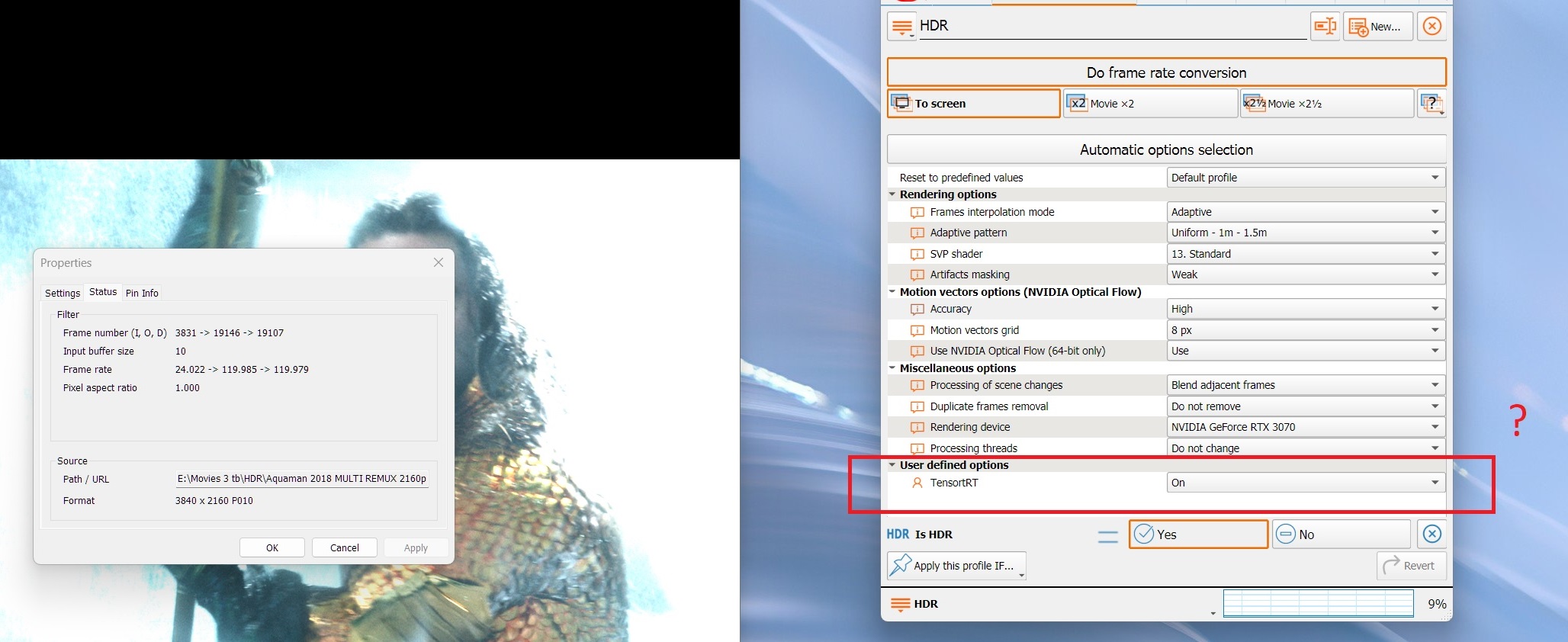

Now that I was able to enable vapoursynth whit MPC-HC, does it make any sense to use other profiles? I'm trying and I don't know if I have a serious case of placebo effect or it looks better, adding to the question does the TensorTRT option do something in this context? . Using another profile that is not RIFE.
Cons and Pros to used instead of AviSynth Filter
Re: Howto setup MPC-HC with SVP + RifeAI + MadVR ?
your profile is wrong
you should follow the guide
https://www.svp-team.com/forum/viewtopi … 483#p81483
https://cdn.discordapp.com/attachments/290709370600423424/1062949400957165598/image.png
should be look like this.

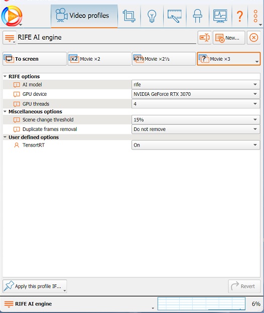

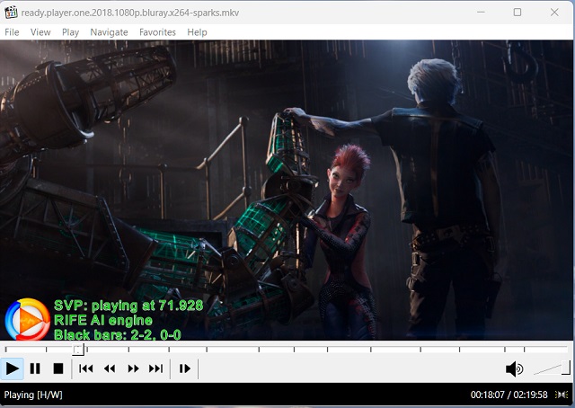

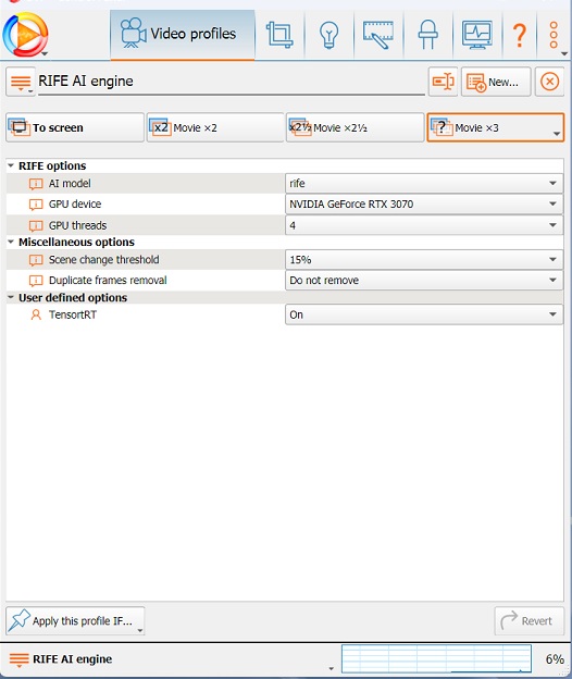

I think AI model has to be "rife" as well for the newest script or am i wrong ?
20 (edited by Drakko01 12-01-2023 11:49:39)
aloola wrote:
My profile is not wrong. You didn't understand what I meant, I was talking about using other profiles apart from RiFE, and if the Tensort TRT option did anything for the other profiles. Besides that, if there was any point in using VapourSynth instead of AviSynth,for the other profiles.
Play_RiFE_ok.jpg, 88.38 kb, 640 x 454
RiFE Profile_ok.jpg, 70.66 kb, 526 x 624
no and no
OK Chainik, with other profiles I will use Avisynth then, thanks
