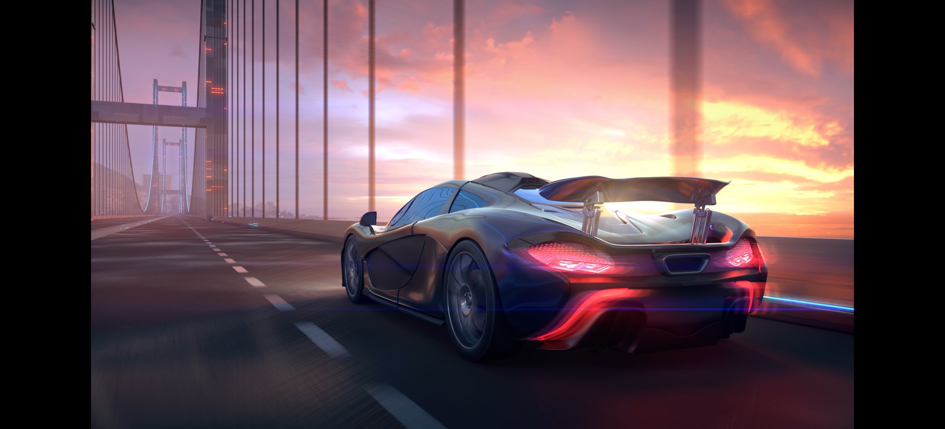

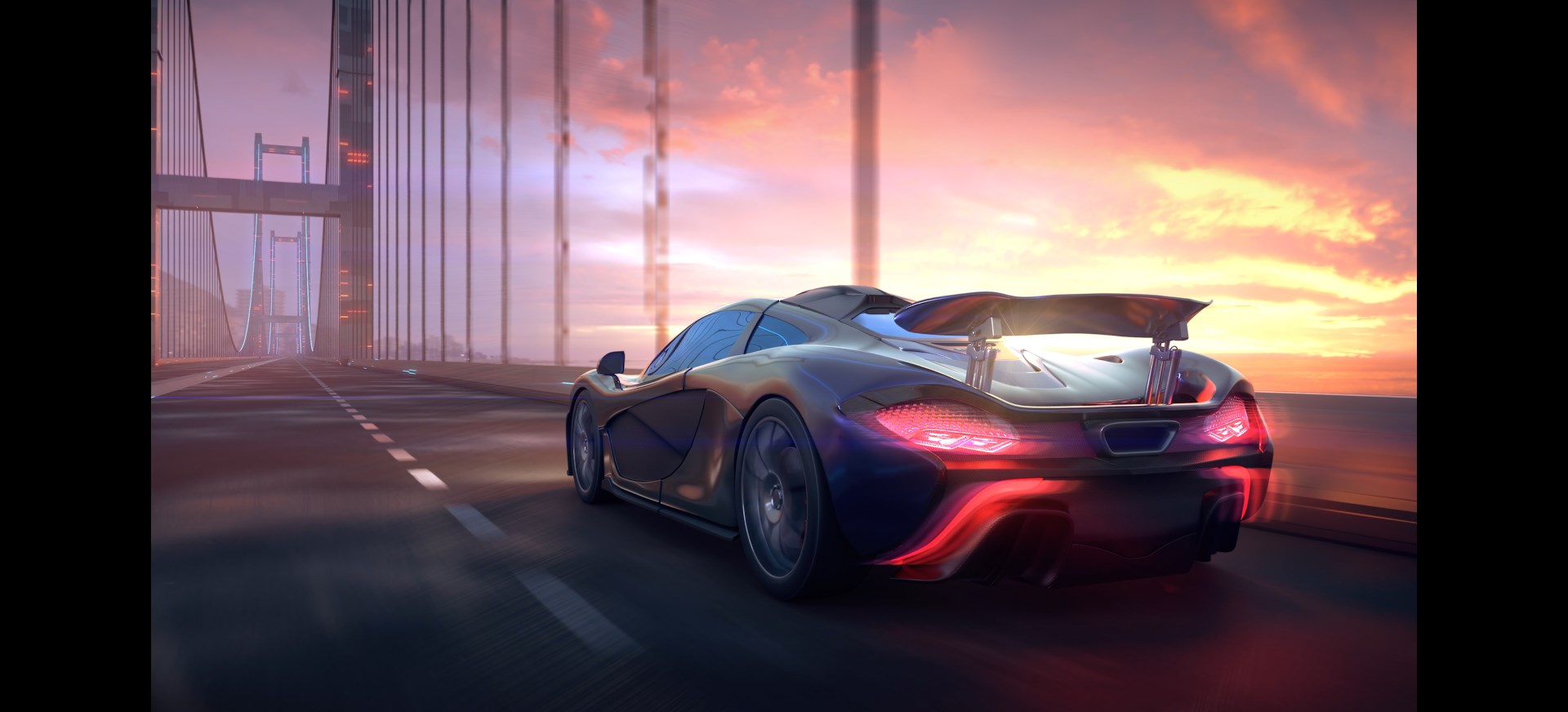

when I set up my profile and watch the video in MPC with x2 framerate it gives nice and clean animation. But once I try to convert this video to x2 framerate using transcoding,  I get the artifacts on the vertical lines. Check the examples:
What I see in MPC with SVP 60fps enabled: https://www.svp-team.com/forum/misc.php?action=pun_attachment&item=5410&download=0&secure_str=12840f7
What I see after the conversion to 60 fps: https://www.svp-team.com/forum/misc.php?action=pun_attachment&item=5409&download=0&secure_str=12840f7
What am I doing wrong? What settings do I need to check\change and why does the result in real-time animation is different from the transcoded video?

1. the first sample looks like a copy of source frame, not a calculated intermediate one
2. if you have 'automatic options selection' in the video profile, then transcoding will choose the highest auto settings, while in a real time it depends on the system performance
