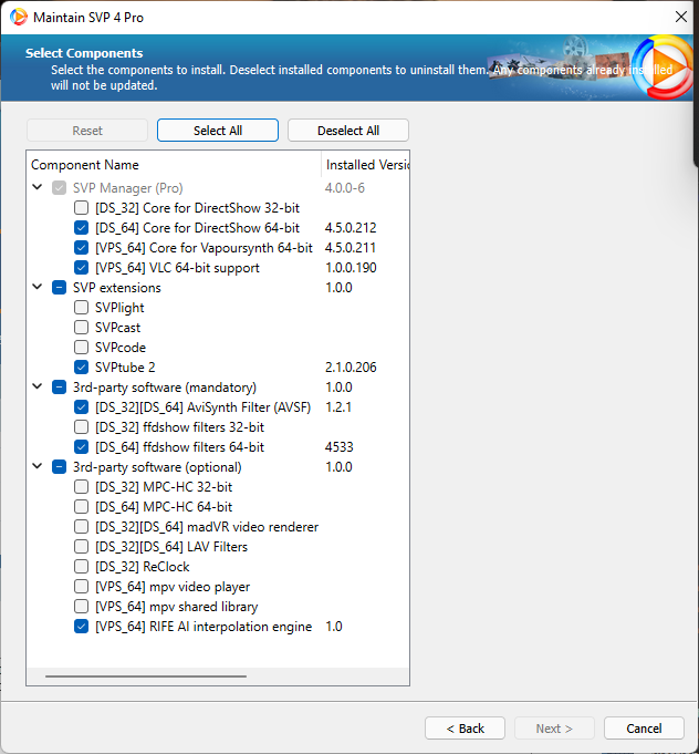

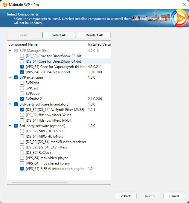

10 (edited by egandt 11-10-2021 19:29:52)
Re: Windows 11 build 22463.1000 constant explorer crash.
I did remove ffdshow so I now have installed:  LAV and madvr are through other software, I can not install directshow as that installs ffdshow, so now the product does not work at all.   When I reinstall directshow 64bit I get ffdshow again, see second image, which seems to be working, but again has ffdshow.
I did try vapoursynth, but am having no luck as the script does not work, separate topic that.
ERIC
svp4-maintenance_5jPuf28Dw9.png, 73.35 kb, 632 x 681
svp4-maintenance_MxHuipCKWg.png, 68.97 kb, 632 x 681
add Avisynth Filter instead of ffdshow raw filter
MPC-HC bundled with SVP is using it by default since ... this spring, I guess
then you can uninstall ffdshow via Window's "Add or remove programs"
Thanks that worked.

complete reinstall of the svp 4 pro.
Open svp4pro leaving it open in the tray , go play a game with browser open watching a stream
13:58:16.098 [i]: Updates: checking now...
13:58:16.443 [i]: Screens: screen 0 - 2560x1440 @59.952 Hz [measured], x1.0 [108 DPI]
13:58:16.838 [i]: Screens: screen 1 - 2560x1440 @60.001 Hz [measured], x1.0 [93 DPI]
13:58:16.838 [i]: Screens: primary screen is 0
13:58:17.367 [i]: Tube: youtube_dl ready
13:58:18.517 [i]: Performance: quick estimation = 763 (previous value was 777)
14:08:41.085 [i]: AVSF: found new player instance
14:08:41.088 [E]: AVSF: communication error [0]
14:35:07.302 [i]: AVSF: player closed
14:35:07.302 [i]: FFDShow: remove instance [19075e]
14:35:08.784 [W]: VideoPlayer: new instance found in explorer.exe but SVP can't talk to it.
No ffdshow installed on the system
https://imgur.com/bidL2ke
No ffdshow installed on the svp manager
https://imgur.com/XakBMwp
Edit: oops dididnt see your reply before i post this , i will try that out and report if it still crash. thank you smile
