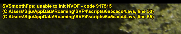

Topic: SVP avisynth error on Nvidia RTX 2080ti studio driver 460.89
SVP avisynth error on Nvidia RTX 2080ti studio driver 460.89. Only while forwarding video .

The error from your log:
AVS - SVSmoothFps: unable to init NVOF - code 917515
You can disable NVOF to avoid the error.
Why you need Studio driver?

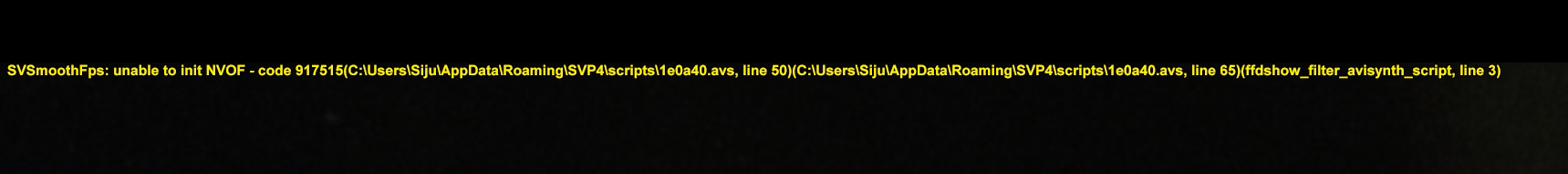

Re: SVP avisynth error on Nvidia RTX 2080ti studio driver 460.89
Avisynth filter quality is awesome. Even after disable nvof this error shows up in mpc-hc
not sure it's related to the "Avisynth filter quality"...
btw, this error code means nothing - i.e. "indicates that an unknown internal error has occurred" while creating GPU memory buffer
to be clear: it comes not from our (SVP's) code but from the video driver
I meant Avisynth filter does a better job with Madvr & SVP than Ffdshow esp with 10bit hdr. I get it that it’s a driver issue , what are those avisynth script ylines in the errors? Thanks for your help . A very happy new year to the SVP-Team. Wish you all the best for 2021.
