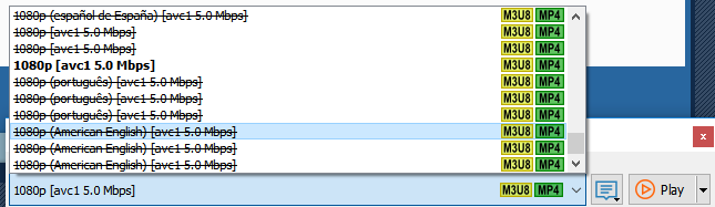

I've used svptube with Crunchyroll successfully over the past few months. Recently though, autoplay from clipboard has stopped working in regards to mpv; other players seem to launch fine... Weirdly it seems that choosing the uncrossed out "1080p" or normal resolutions will cause mpv to launch incorrectly. I can see the process in my process list but no window pops up. Logs just say mpv connected, waiting for video info.
However, going into the list and specifically choosing one of the crossed out names, i.e American English will launch mpv successfully. Also weirdly enough, if I manually launch mpv from the svp folder first, then autoplay will work successfully.
I've had my main computer and test computer both experience this problem. Anyone else having this?

Re: MPV having troubles with Crunchyroll?
Thanks, yes it works after I select a different format or line.  I selected the 1080p without the crossed out text, and this was the one that gave me problems.  I selected a different 1080p with the crossed out text and it worked.  It was like the instructions that the OP gave.
